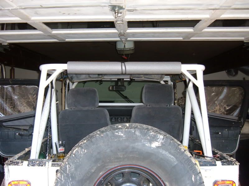

Here are some pics of mine.....
1-3/4" DOM Tubing with home made padding from plumbing supply house.

Did How did you tie it into the roll bar? I am guessing you welded, but what about in the very back bottom where it ties into the tub. What did you do there? Does a Bestop Softop and hardtop still fit?

Stu: What thickness is this tubing you used? What does the DOM stand for?

DOM I think stands for Drawn Over Mandrel. It is manufactured with tighter tolerances on the wall thickness and meant to be used for structural applications. Mine was .120 wall thickness. BTW, I have no illusions of it being a complete roll over protection - just as Jeep designates the factory cage as a "sport bar". Mine was done primarily to help secure people in the back seat and provide a frame for my Cali top which doesn't use bows.
I welded it to the existing bar in both locations. In the front I welded the stubs for the windshield extentions to the main hoop so that I didn't need to worry about them coming loose. I fitted the rear hoops so that they tied into the diagonal bars just above the attachment plates. I would think any top would fit. I have a CJ hard top that I use in the winter and a Cali Multi top that I use in the summer and both fit with no issues.

I plan on doing the same with my sport bar. I like the padding you used. It has a nice clean look. You state this was homemade from a plumbing supply house. Is it covered with fabric, or is it straight foam? Can you elaborate on the padding any? I plan on using these Rear cage bars for YJ/CJ - JeepTubes.com (or something similar) to build up my existing bar along with a cross bar across the back as you did. I only need to source the padding, and yours looks like what I want to finish off the project.

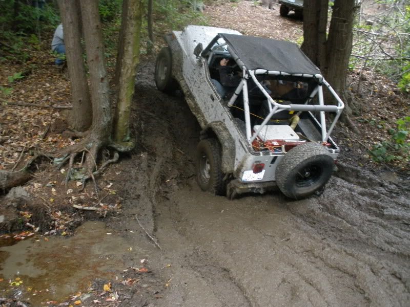

i added a rear section and pushed it back a couple inches to maximize useable space. i cut the down bars out as they are extraneous and make it impossible for people to get in and out. really no need to have a "family" cage if no one is going to be in the back. the holes for the spreader bars were also filled in by grafting a portion of the old tubing into the factory hoop.
