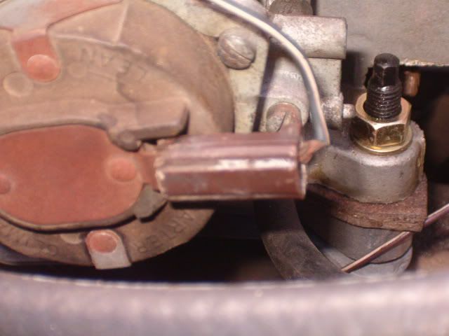

It should be a blue wire with a brownish connector at the end coming from the firewall, ill get a picture up later, hope the PO didn't cut it.

Sorry its a extreme close up of where it connects, that wire just goes into the loom of wires at the firewall. Not to sure of what it does from there, you'll want to tie it into the ignition relay so it only draws power when the engine is running.
