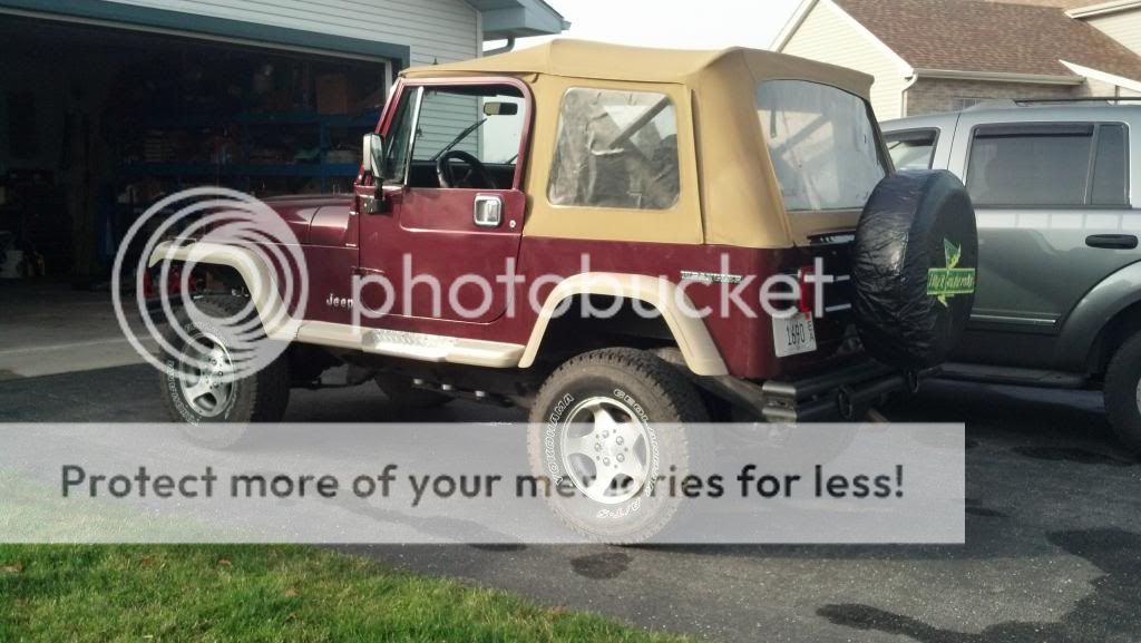

This is the parts list that I have so far. I put on Rancho 5000 shocks less than 2 years ago, so I'm hoping that I can use for another 6 months or so. They're rated for 0-2.5" of lift, so hopefully that will work. Am I missing anything?
I'm planning on just cutting the old components off to make installation easier.
Oh, what size bolt is used to connect the non-shackle end of the spring to the frame. I think that's all I'm missing.
I've had this 95 since 98 (under 100K miles on it!), and I've babied it. It will spend 90% of the time on road, so I'm really hoping to improve the ride over the saggy factory springs.
Thanks for the input, guys.

If you can, wait on the tc drop until its installed and you give it a test drive. Might not need it. You can also have beserk or vacj7 (or is it 5 or 6?) make a set of booms for you a lot less than the mores, though they are nice.
You will need to look into brake line relocation or longer lines. Relocation is cheap and easy. Anticanman has some good pics.
Be sure to take out the shims off up front if they come installed.
Ditch track bars.
Righty tighty, lefty loosely.....good luck with the install.

9/16 4.5 inches I believe. My notes are questionable at times or lost.

Yeah, I've heard great things about the forum members' shackles. I just like the idea of the greasables, and that the bushings and all come with the MOREs.
Track bars have been off for a year. I'm -still- kicking myself for not pulling them sooner...

I'm considering the Prothane 1in body lift, as my originals are all pretty mushy. I'll probably hold off on it until after the other work is done to see how the Jeep looks/ feels/ handles without it. Any thoughts about that plan?

Sounds good. I just installed a prothane tranny mount looked like a quality piece, but not experienced with their body lifts. I have a 1.25 inch jks body lift that I like.

That's up in the air for now actually, heh. I currently have 31s on 10 in wheels, with minimal flare rubbing, but like I said, I rarely flex the suspension. I'm going to need new tires, so the plan is to see how I like the setup after the lift, or borrow someone's 32 or 33s to get an idea of how that will run. Aaand... I'm looking at regearing possibly in the Summer.

You will be fine with 31s without the body lift. I would save the body lift for when you move to 33s. If for some reason you just want a little more room don't count out tj flares for a bit more clearance. Think you are on a great path to a nice ride, good luck.
