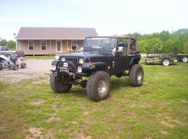

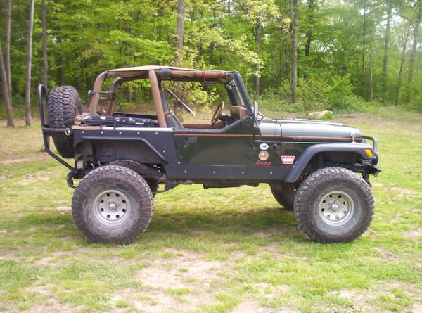

He some pics got it most of the way done, just need to paint the frame and a little bit of wiring but drove it today and went perfect.

wow that looks great

Looks freakin' sweet. I wish my Sahara paint still looked like that.

I used YJ style springs just moved the spring hanger back, I gained a little over 7" of wheelbase, main purpose is to stabilize it better on hills or steep angles. I plan on moving the front axle forward 1-2" in the future but as of now my next thing is some tube fenders for the front.
