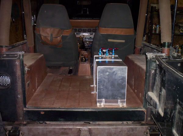

so when getting this cell, I assume you get one that does not have a sending unit and sump. You remember the part number by chance? Summit is about 30 minutes away from my house, so the next time I am up there I will just grab one. An I assume you just open up the tailgate to fuel up? And does the cab smell like gas fumes being that it is inside the rig?

RCI Racing 2161A - RCI Aluminum Fuel Cells - Overview - SummitRacing.com
Yes I have to open my tailgate to fill up. When the gas pump clicks off you are done. Do not try and put any more fuel in it.
I have never had a problem with fuel smell.
I just left the sending unit that comes with the cell intact. I do not think you can buy them without them.

you just cap off all the ports on the cell other than the breather since you ran your stock pump/sender? What ya cut the hole in the cell with for the pump/sender and did ya just use the factory type seal?

There are 3 ports that are located on the top. Fuel out (to engine), Vent (has a check ball for rollover), and Fuel in (back to the cell from pump). The stock pickup is JUNK! If your off-road it does not like having under 3 gallons or so. People take the stock pickup out of the jeep and cut a hole on the top of the cell and put theirs in. This is what I'm going to do mid winter. I run an external fuel pump that sites under the jeep. I have zero issues. You will get the fuel smell unless you mount the vent line to somewhere outside the jeep.

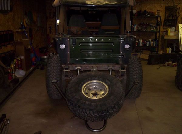

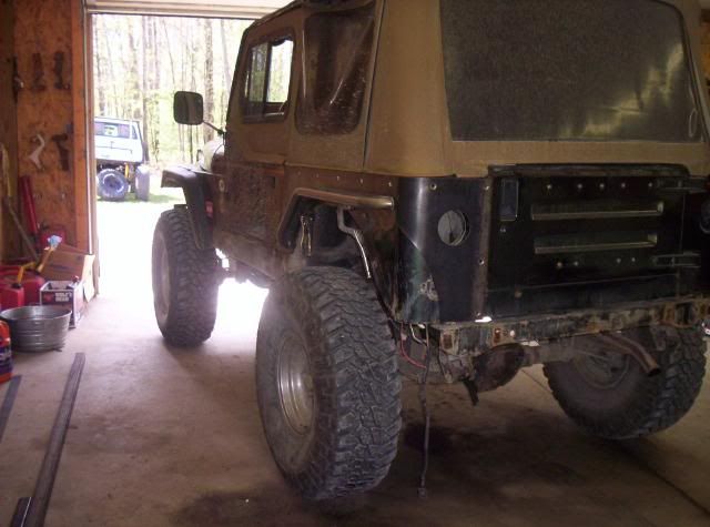

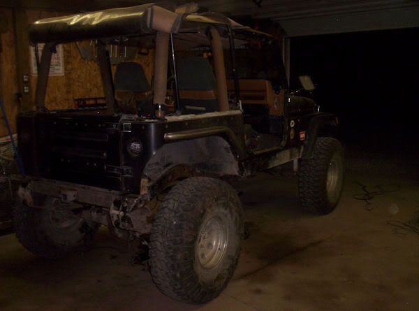

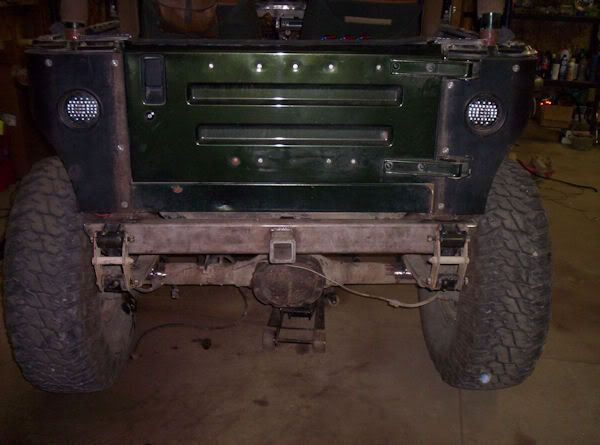

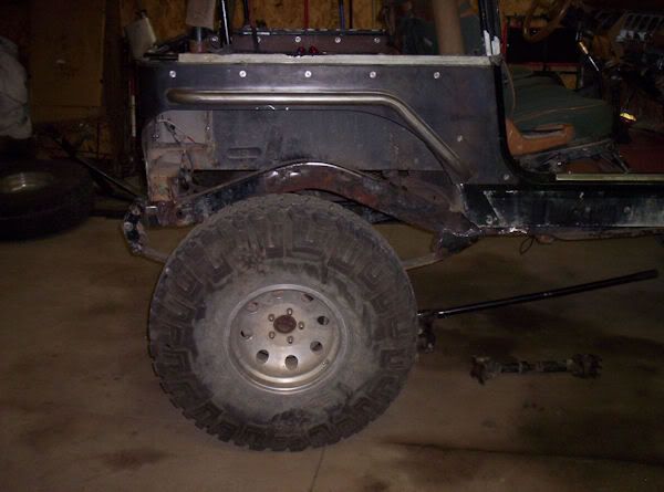

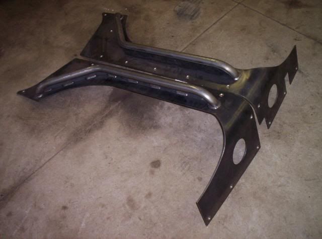

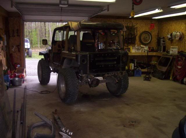

Well finally got it started heres a few pics so far. Used Sniper fab with 3" flare, moved both shackles back using YJ springs, wheelbase is just over 101"

where did you get the rear spring mounts. its really looking good!!! i think this is going to be my next project!! and i wanna do the same thing as you by using the yj springs and moving the front mounts rearward.

Heres the way back shackles I used in the rear
Way Back Shackle Hanger [0690070] - $46.00

Those look real nice!
Has the tank been plumbed yet?

got everything but i am short on some fuel line, I am doin the measuring tomorrow and probably head back up to Summit to get the rest of my fuel line other than that I should have everything for the fuel done, Got two of the Walbro pickups in the tank across from each other, and a Walbro GSL392 inline pump.

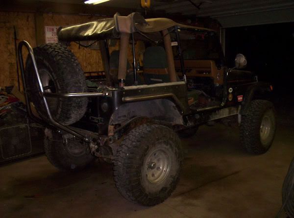

Got the rear stinger put on tonight ordered itfrom Jeeptubes.com real nice kit actually went together pretty good, still need to cut the extra axle shaft for the spare tire off and smooth out the welds.
