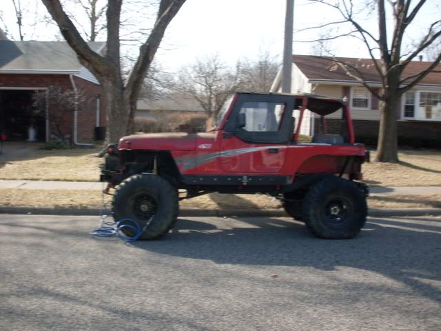

Some pictures. Sorry do not have alot. Can take more on Tuesday if you need more.

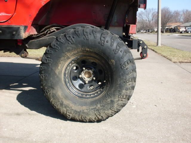

I put my shackle mounts high on the rear cross member so I did not get any lift from it.

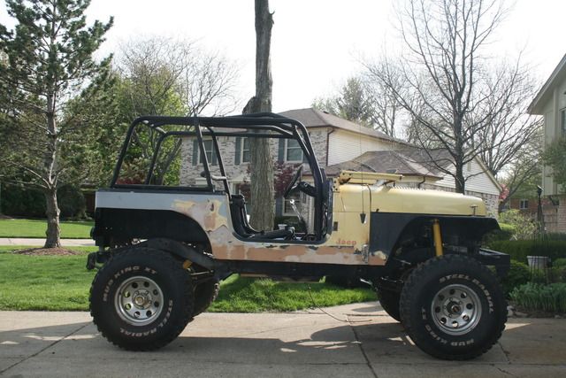

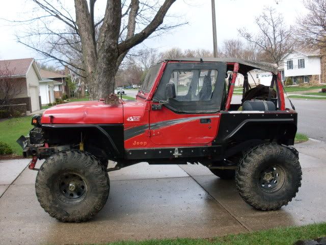

Before corners
After

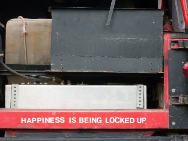

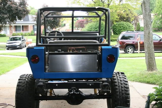

use a fuel cell that fits behind the rear seat
my 6" stretch: I just cut the spring hangers off the frame and moved them back 6" and used the same springs.

I do have to tell you though, I do miss the rear storage area behind the seat.... I know it was not a lot to begin with but.... I will just have to make a rack on my tire carrier when I get around to fixing that.

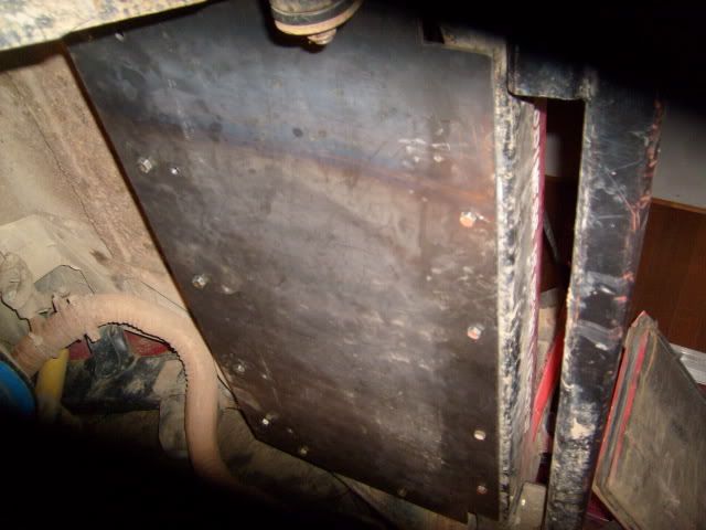

I used the RCI cell. It is the same one Plato2k5 has pictured.
Cut out the rear floor and ran fuel lines.
Made a cross member that is welded to the frame the back is welded to the rear crossmember. There is a plate that is attached to the two that holds the fuel cell in place. This picture is before the rear stretch. The plate is not connected on the rear crossmember at this time.
Cut a hole in the fuel cell for the stock pump and sending unit.
In place
This is why I sank it down. Tool box

As you can see from the last picture that cell is held down with straps. There is also a rubber mat under it and in between the straps and cell.
