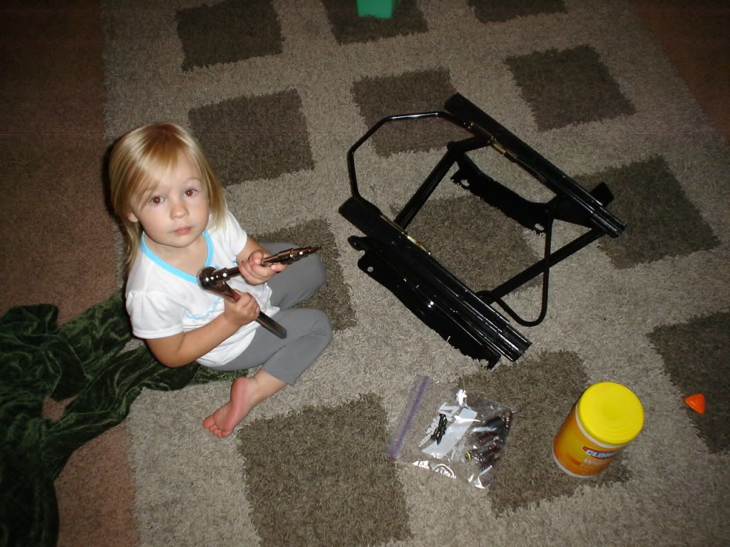

Do you have the whole seat out of the Jeep? Makes it MUCH easier...
Do as said before... Slide seat all the way forward, remove rear bolts, slide back, remove front....
C'mon now! My 2 year old did my seats!

Older thread but since I was looking up how to do this, the answers to the op's question bothered me so I figured I would help the next person who stumbles on this post. Don't look at the rails but under the seat and up. The screws that need to be removed are going into the seat NOT from the seat down. Slide the seat forward and look up. You will see the two torx screws. Slide the seat back and look up. You will see two more torx screws. If people just answered the op's question this way it would have actually helped him. And we all know the kid did not remove the screws. =-)
