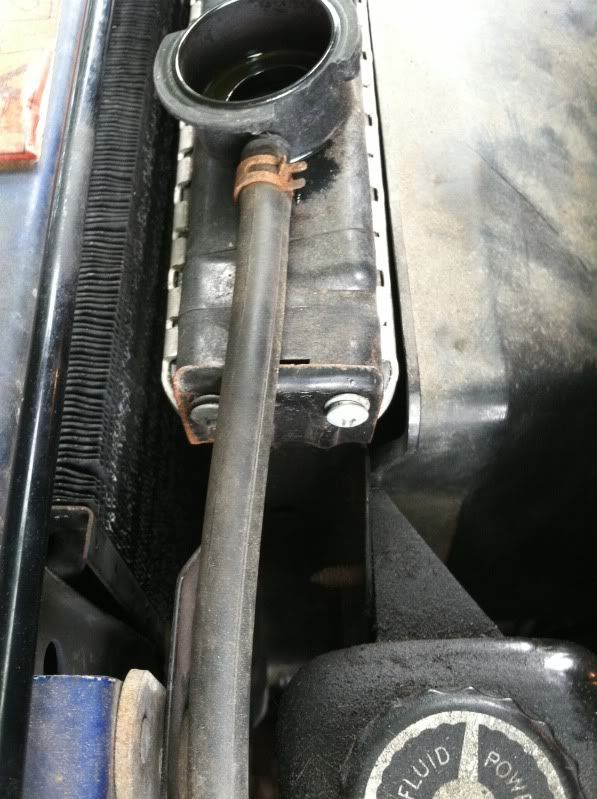

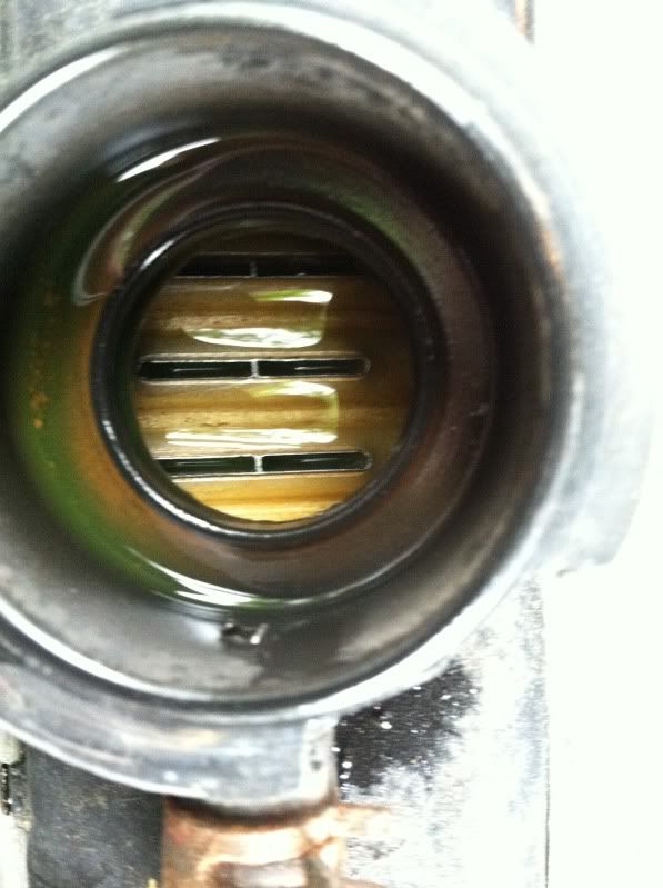

Filled mine this morning. Took pictures:
Not to be under knowledgeable here but mine looks the same. Is yours a one or two core?

I'm not 100% sure. Like I said, there was just one replacement model radiator offered. I think it's a two core looking in the cap.
