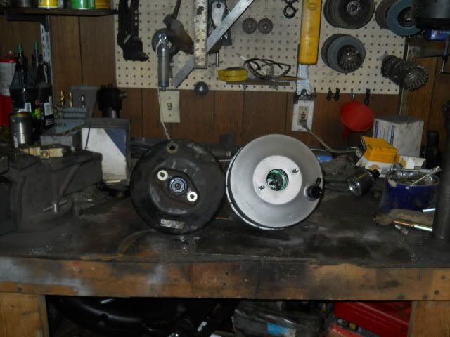

Here is a picture of a stock 93, 4.0L, single diaphram booster next to a 95, 4.0L, double diaphram booster.
I have not seen this picture so I thought I would post it. Stock on the left.
