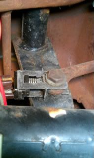

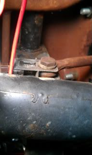

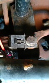

Yes - don't throw anything away! I tossed my leaking '87 booster, and I am pretty sure that the brake switch bolt, and other fittings went in the recycle bin with it. Can't find the spacers anywhere! If you can provide a picture of the switch in-place, I would really appreciate it and maybe I piece this back together.
Also, I think that I am missing a seal or something where the pushrod passes through the fire wall. As shown in the picture, the rubber seal does not reach the firewall and it looks like a direct path for water into the cab. I noticed in another writeup that original '95 bracket looks more like a pipe section that the rod passes through and appears to be weather tight. I have the '87 bracket, which looks like the one you have. Did you do anything else to seal it, or did I throw out a crucial part? thanks

PM'd you. Here are a few pics of the switch:
