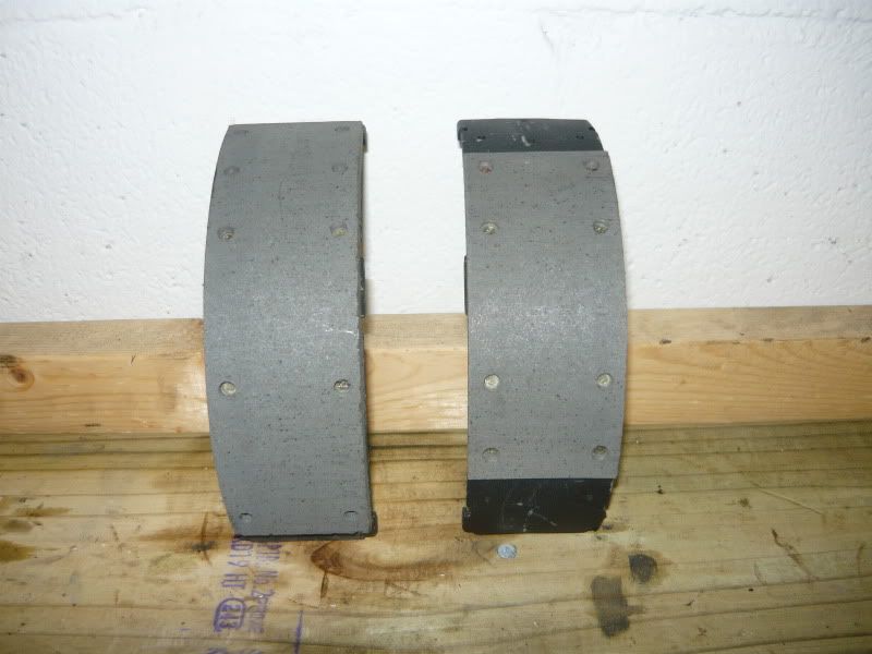

Check the shoe to drum adjustment as I suggested & if you feel energetic enough, make sure the new shoes are oriented properly with regard to "leading shoe" and the "trailing shoe" placement. This will maximize efficiency once you get things sorted out.
For reference, the trailing shoe uses the most amount of friction material, while the leading shoe has less material.
Trailing shoe on left, leading shoe on right.

Leading and trailing shoes were on correct, but were really far out of adjustment (a good 6 full turns on adjuster before they made light contact with drums.
