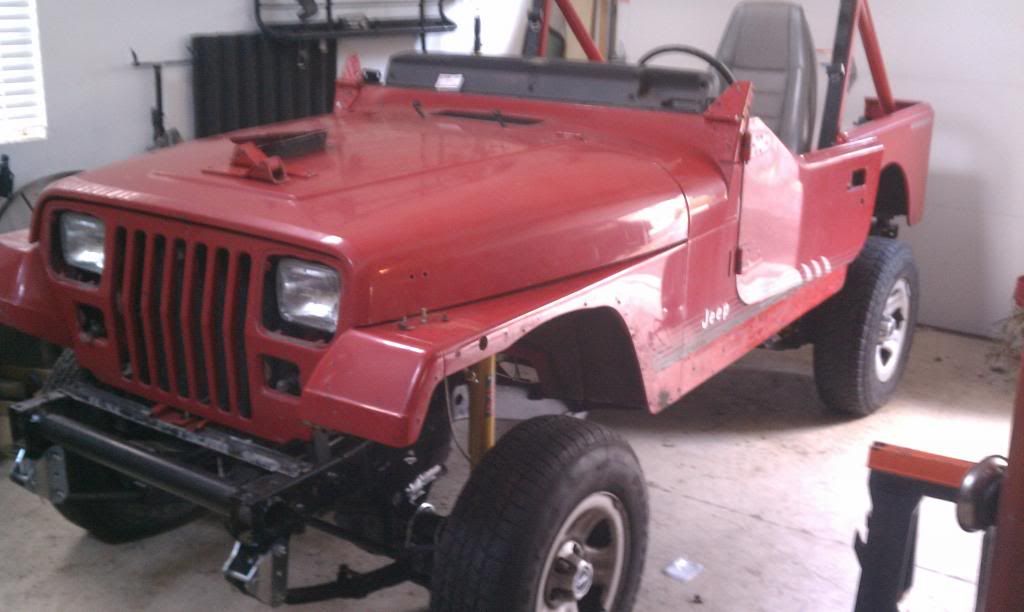

Finished the brown dog mml w/super brackets install, changed the oil pan gasket and started reassembling the exhaust. I recruited my bil to help bleed the brakes. Put the rolling tires back on too.

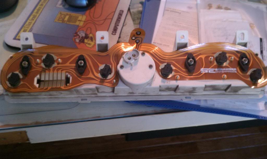

I also started putting the dash back together. I have a new flex circuit board for the gauges that I just started installing.

Just finished installing a new flexible circuit board for my gauges. I got this off eBay and it is nicely made with a coating over the traces. This should help cut down on the corrosion.
If my plans hold I should have the dash back together, exhaust installed, and front driveshaft in. Hopefully I will get the Jeep started too!

After a slight detour to replace the radiator and steering box (Dodge Durango box) on my 89; I am back to this resto-mod.
The new gauge circuit works great and should last much longer than the stock one. I have the dash back together now, and I am looking for a painter. Not looking for a maaco job or a show truck job; just something decent and affordable.
I put fuel in the tank and fired the jeep up without issue. Of course, with nothing after the header it is quite loud. Not to mention the overflow bottle cracked in my 89, so I had to scavenge the 91's overflow bottle to finish the 89. Now I have a plastic bottle temporarily serving as overflow until the one I ordered comes in.
I am on the hunt for front seats now, so I'll have to begin combing the forum for the seat threads.
I started reassembling the exhaust and picked up another useful tool, an exhaust expander. It takes a long breaker bar to turn, but done slowly it made the joints slip together nicely.
I sent the Cherokee front driveshaft off to be cut-down, and balanced. This is going to cost me about 160.00. Cheaper than a Tom Woods Drive shaft for sure.
My goal is late April/early May I'm back on the road and getting ready to lay down Monsta-liner inside.
jeep63 is offline

All ready for paint now...
I just have to tow it to the paint shop now. Plan is to drop it off on Thursday.
I pick up the rear drive shaft later this afternoon, and should have it in by tonight, the front is ready too.
Once it comes back we will do the Monstaliner in Read My Lips.
That may be light I see at the end of the tunnel.
Looking forward to wrapping this up.
