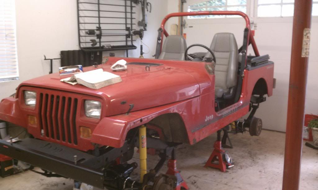

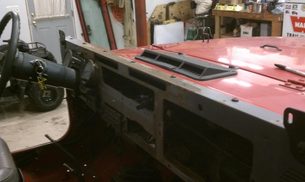

Made some more progress...
Pulled the windshield frame down and I am pleasantly surprised at the minimum amount of rust underneath. Nothing is rusted through and it is centralized to the center. I pulled the dash pad off and got it mostly cleaned up. I plan to hit it with a primer and topcoat or just use some of the left over por15 I have; not sure yet what I will do.
I picked up "nused" windshield frame that is black and has absolutely no rust, and a perfect windshield that does not leak. Finished running new hard lines for the brakes, and I installed the new steering linkage. It is "close" to the original alignment since I counted the threads that are exposed on the old linkage and set it up the same on the new. I am sure I will need to perform a final adjustment using one of the methods I have read about on the forum.
I also picked up an XJ front drive shaft to use as my rear drive shaft. I'll have to take it to get cut down, but there are two places near by that do that work reasonably.
Here are some recent pics...

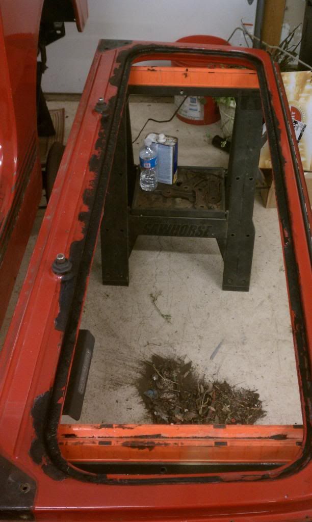

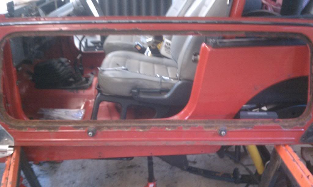

Since I have purchased a new windshield frame with good glass I took the opportunity to learn how to remove a windshield using my original windshield frame. It took some doing, but I got the glass out in one piece. I also discovered that this frame may be salvageable. The inside and bottom are prefect. Where the glass sits and around it is rusty for sure, but the steel is solid. I am considering cleaning it up and re-using it, and keeping the one I purchased as a spare for my 89 (which is black so it matches).
The glass was clearly not sealed well the last time I had it replaced and this contributed to the rust. I took some shots of the frame and am interested in opinions...
Here is the front where the rust is...
another shot of the rust...
The inside...
The bottom...
Has anyone had luck re-using a windshield with this amount of rust?
I have a lot of cleanup to do, but it looks doable to me.
jeep63 is offline
post #35 of 130 Old 01-26-2013, 05:38 PM
ashland82391
Location: Chandler
Posts: 7,977
Is just surface rust,I think you'll be fine

Posts: 292
Mine had about that, I sanded the crap out of it and kept poking with a punch to see of it was weak anywhere. When I was satisfied it was solid, I put a new windshield in. Held up all summer and so far this winter with no leaks... Granted mines only moved maybe 5 miles since then too lol

Yeah, I figured it was worth a shot.
I hit it with a wire brush and went around with a punch. It is solid, so I cleaned it up as best I could and used permatex rust converter. It is all black now and ready for paint.
I am psyched about this find. I thought for sure it was toast.
I am looking into a windshield install now. After I paint it of course.

Posts: 785
More progress...
Removed the tailgate and hinges. Had to drill out the lower hinge and then use heat and vise grips to pull the bolts out of the lower support bracket. My hinges are shot and I have been researching using TJ hinges, but from what I can tell they are not a direct swap. I am only going to 31s; I think even those are too much for YJ hinges. Anyone have luck swapping in TJ hinges?
I plan to pull the passenger fender off to replace it and then start to shop paint options. Any tips on removing this fender?
I may slow down and move to my 89 for a while. The steering box needs replacing along with the radiator. Plus there is something going on in the rear of that Jeep too. I need to keep it up so I have a Jeep to drive while the 91 is being restored.
