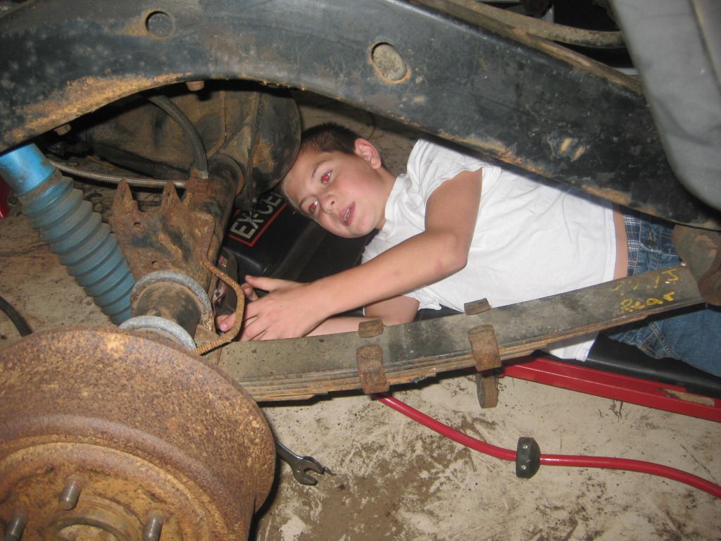

We started tearing it all apart now. I plan to do as much of a frame on restoration as possible. I have dropped the xfer case skid and the gas tank one. The skid plates need replacing, I found a gas tank one, but I'm still searching for a xfer case one. The frame is solid, so I will just paint it with POR15, and the Chassis coat on top. I am working on taking the axles and springs off to paint them too. Here are some shots thus far...
My son taking off the shock... (Yes, I got on him about not wearing his safety glasses)
I'm hunting for a windshield frame, tailgate, and passenger front fender. I am still debating trying to paint it using foam rollers or use money he and I have been saving for the paint job.
The xfer case is leaking, so I need to take that off and fix the leak. I am trying not to let this snowball into a full blow restoration. Just a mild one...

Finally have one of the rear springs off. The spring hanger eye bolts are seized to the bushing sleeve. I had to cut the ends off and pry the spring out of the hanger. The springs are not too bad, but I am considering going OME or BDS for a small 2" lift. I would prefer no lift, but if I get new springs I might as well go for better riding ones than OE.
I got the old 2" body lift off. It was not too bad. I used anti-seize all those years ago and only one gave me a fit and that is because the bolt was stuck to the sleeve and would not "drop" out. I am replacing all of it with a 1" poly body lift that comes with new bushings, etc...
I am still searching for a new xfer case skid... These stock skids are hard to find. Quadratec sells OE replacements, so I may have to go there. So far everyone I call with a parts jeep has the same story... "Skid is shot because holes are rusted out". I considered a UCF no body lift skid. I have one of their ultra high clearance ones on my 89, but there are no drain holes and it makes a huge mess when you drain the tranny/xfer case. Plus that is $100.00 more than the Q'tec OE replacement one. This is not going to be an offroad jeep. It will be a run around town/beach one.
