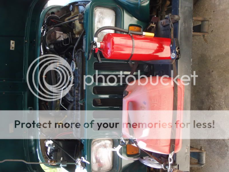

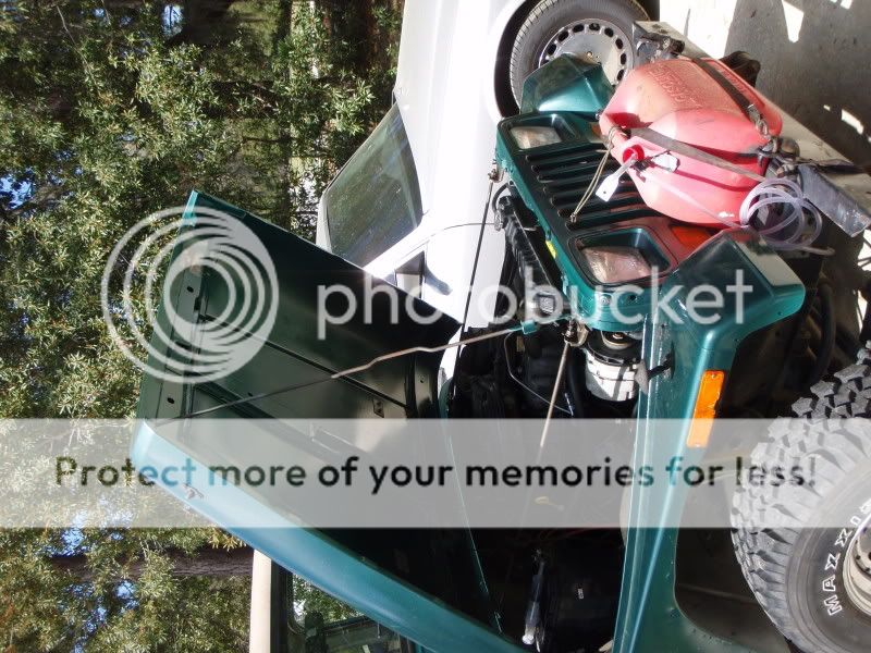

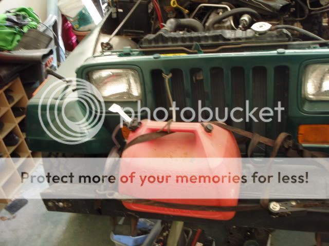

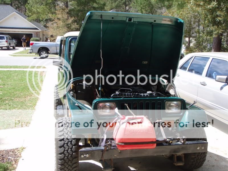

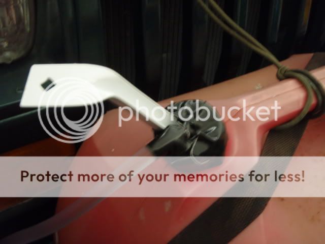

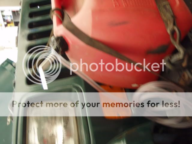

So this will be my third try posting the fact that I got it going today and constucted a very redneck fuel tank on my front bumper.
Each time I got to upload the pictures my computer locks up and my two or three paragraph write up gets deleted.
So short and sweet and I'll try to get pics up when Photobucket decides to start working.
It drove today. Got it to idle all day and adjusted it to around 700 or so. Got it up into 5th gear and have been able to rev it up to 2000 or so sustained for quite a while with no major problems to speak of.

Heres pics.

Originally Posted by green89yj View Post
your gunna need that fire extinusher haha with that gas tank. hope you have better luck with the carb or you culd just swap the 4.0L now

Yeah. We got by without using it. I wish I had time to do the 4.0 swap now. I might end up keeping it and just buying a holley or weber carb. It seems to be running ok now. I mostly just wanted the AX15 that came with it. How much do you think I could get for it?
