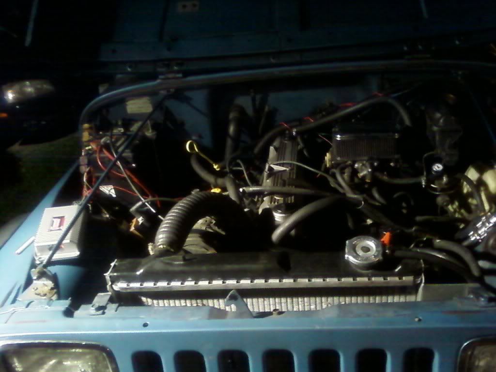

by october of 2010 i had my jeep running like a dream. i did the nutter bypass first, then i put the pre- smog distributer for an 82 cj in. after that i read up on the tfi ignition and did that with the ford coil and ford cap+wires.
i also found a tag saying my engine was rebuilt in 2001, went back to my tittle search and it turns out the jeep was off the road for a few years at that point and was only 40k miles ago

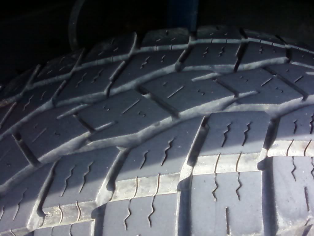

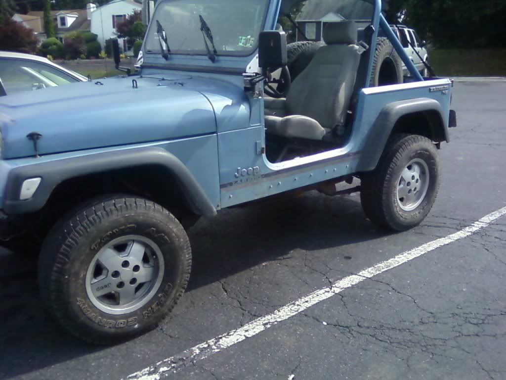

i picked up a set of 31's today for 125 and the guy mounted and balanced them for me for $60, he was really nice and gave me a great deal so i gave him all the money in my wallet minus a few ones, $190
tread is almost like new
jeep sits a little higher now
on the way to get them mounted and balanced
the best part is now my death wobble is gone

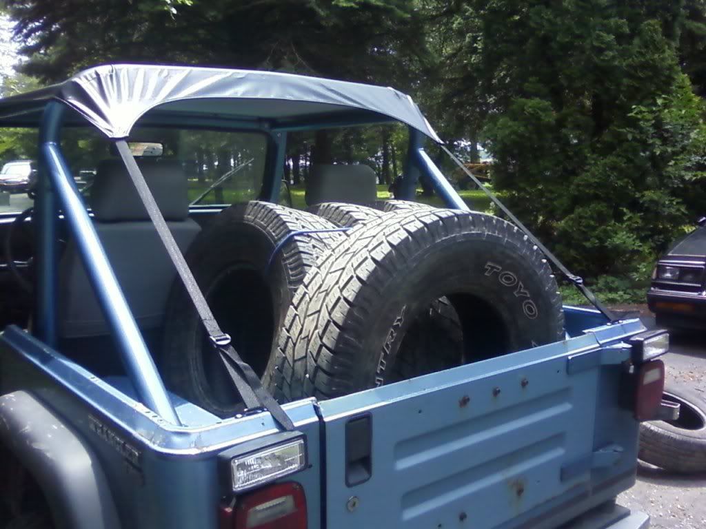

oo and i got a new bakini top because a strap ripped off the old one

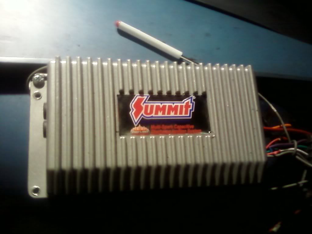

i ordered the summit racing CDI box, it is supposed to come friday. if it does ill put it in and see how it goes.
i did the ford tfi upgrade a few months ago, so would it be better to use the stock ford tfi coil or a canister style accel supper coil i have in my garage?

i got the summit racing cdi ignition, now i just want to get a new set of plugs and try the gap at .50. they are currently at .45.
i still need to get a tach adapter so my tach will work again and i wired the 12v switch line to a kill switch until i get the diode in place.
