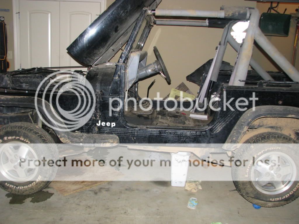

here are some pics and yes that is a bullet dent in the left rear fenderwell
i597.photobucket.com/albums/tt58/nichols0807/various807.jpg[/IMG]

wwell now you gotta tell us the story about said bullet hole. haha
But nice looking yj.

looks like a good base. You definitely have to tell us about the bullet dent/hole though.

Yeah it is a good base no rust (except some surface) just needs to be cleaned up a bit. As for the bullet dent, the reason its a dent is because it hit right where the interior fender well and outer wall meets and it was shot from a distance. Me and 5 other buddies(we were piled in)left a friends fishfry(in a not so good neighborhood, shouldnt have been there) while we were leaving I slowed down at a stop sign but decided to run it(THANK GOD) I heard a popping sound and thougt it was fireworks, turned back to my buddies and they were all ducked and covered so I gunned it. Found out from the State Troopers who arrested the kid later for something else that he shot a 38 out of a 9mm or viseversa that happened in 96' and that he just didnt think we belonged in his neighborhood. Gotta remember the town I was in was only 2300 people no big city.

Well thats fun. It already looks to have a little bit of lift from the pictures but maybe that's just the camera angles. It could use a pressure washin though.

Yeah needs a good cleaning. Havnt washed it in a couple months. As for the lift they are custom 3ton jack stands its sitting on LOL (there under the front and rear bumpers) . The stock springs are as flat as flat can get. I will be putting a RC 4" on it in the next couple of months. Dont do alot of offroading just hunting.
