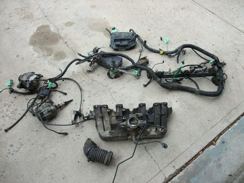

Pics fixed...
Pulled the entire MPFI harness out of a '92 Cherokee today along with the alternator, distributor, intake manifold, ECU, and relay/fuse box (fuses and relays included). Total cost of $55. Need to order a CPS kit from Hesco and then I'm set to wire it up.
Fuel Rail/Injectors
Intake Manifold
ECU
Alt/Distributor/Coil
Relay Box
Everything
