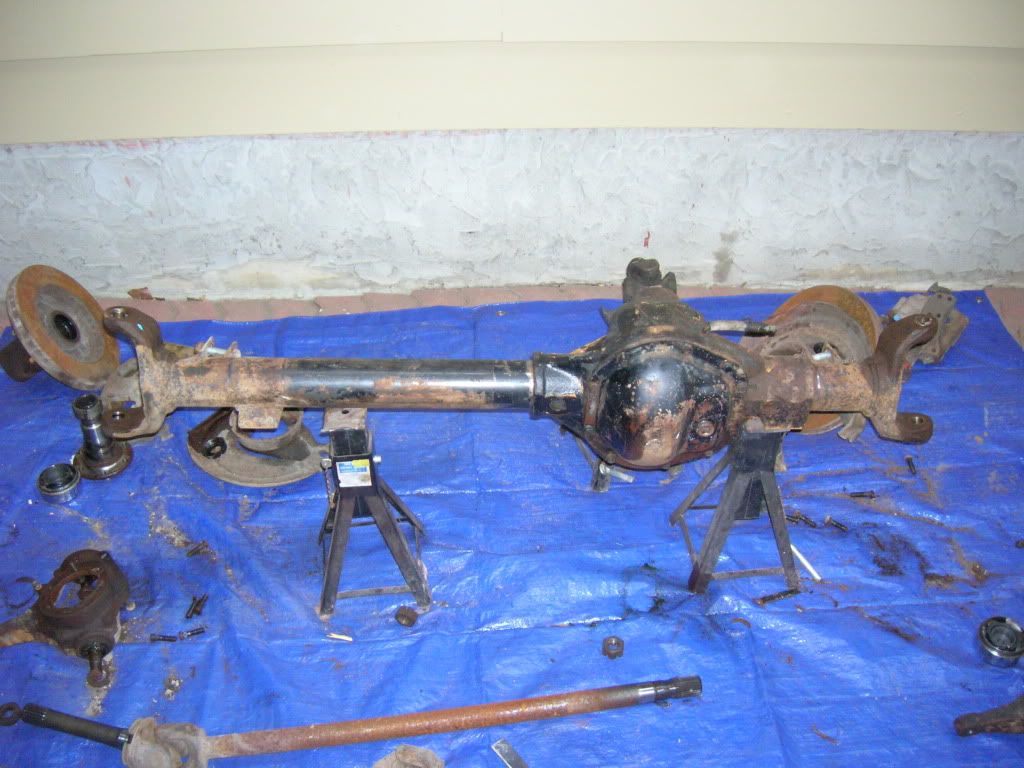

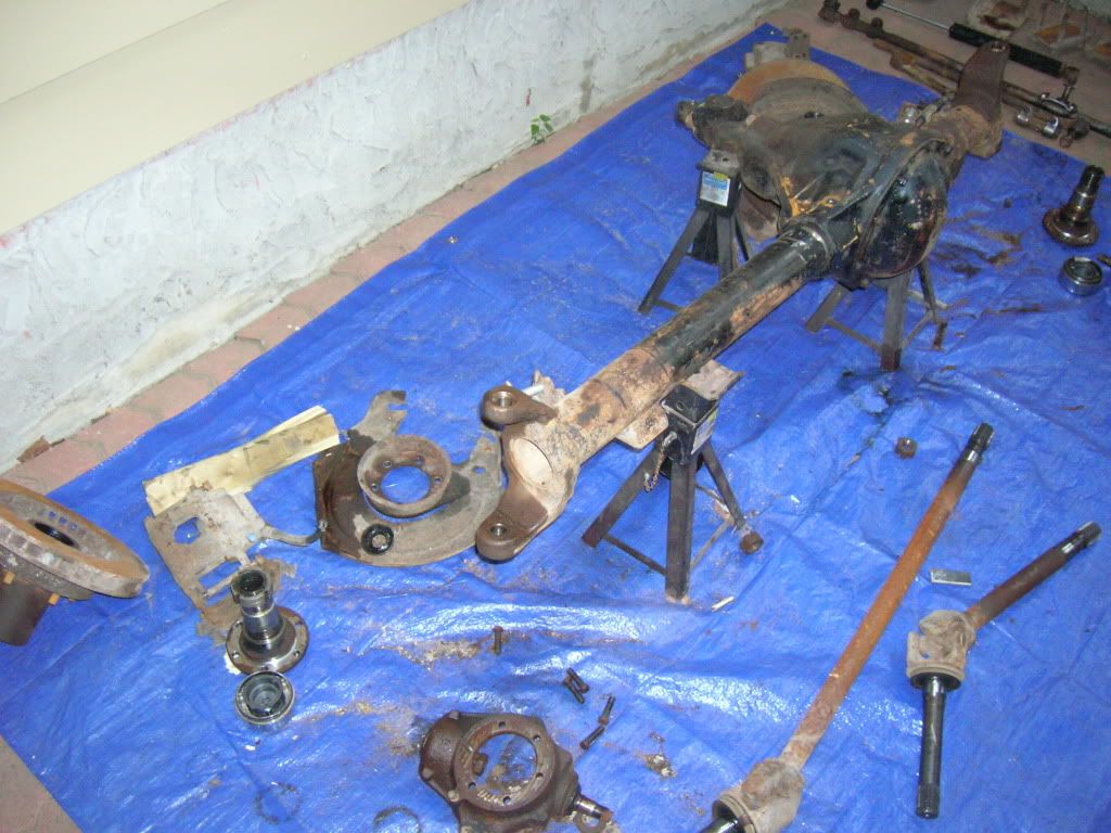

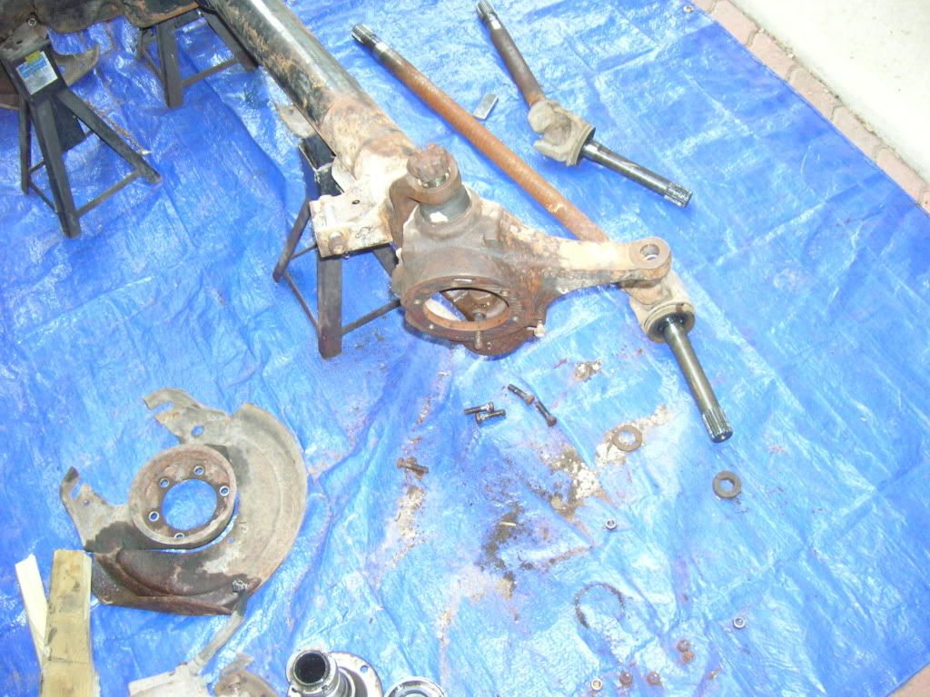

Here is the axle stripped down to the knuckles and with the shafts pulled

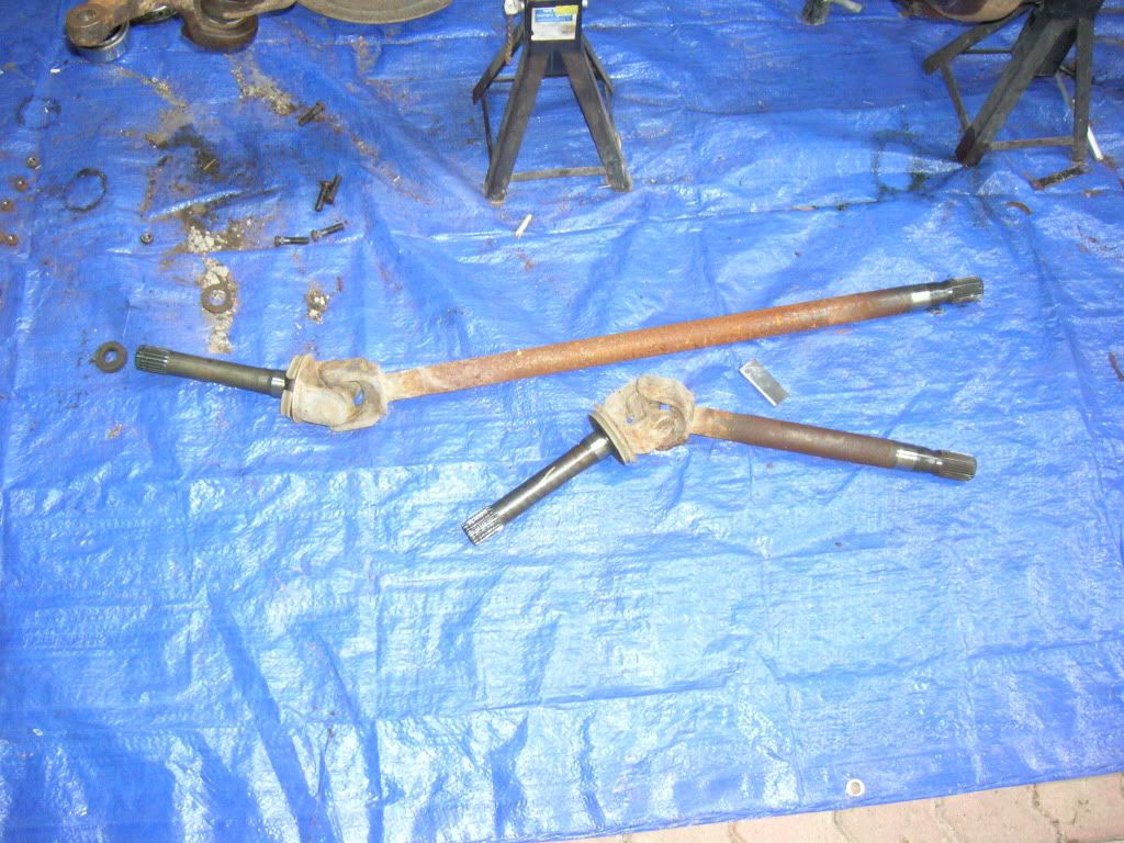

And the shafts themselves
Today, I picked up a pickle fork and knocked the knuckles off. They actually came pretty easily, I expected more of a fight.
It is actually kind of funny that before I stripped this thing down my dad and I could barely lift it. It weighs almost nothing now compared to then.

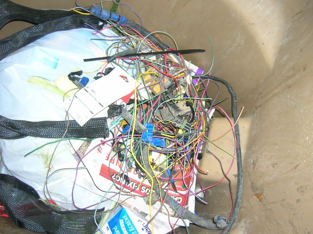

Well, I got something non-axle related done today. Removed all the excess wiring from the computers. There was A LOT of useless stuff in there and it feels really good to rip it all out.
This isn't even all of it, just round 2

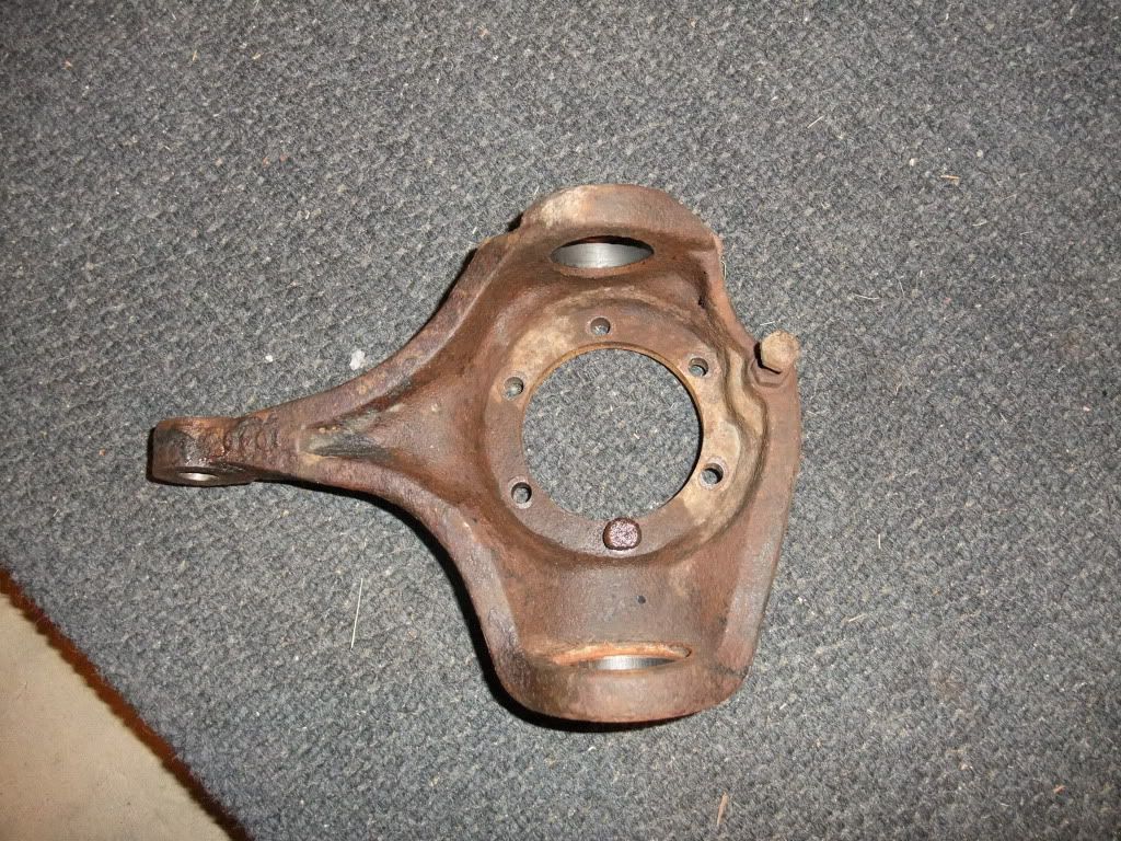

I also have some pics of the knuckles stripped down. I think I am going to use electrolytic rust removal on these, opinions?
As you can see, the studs are removed. This had to be done to get the spindle off.
