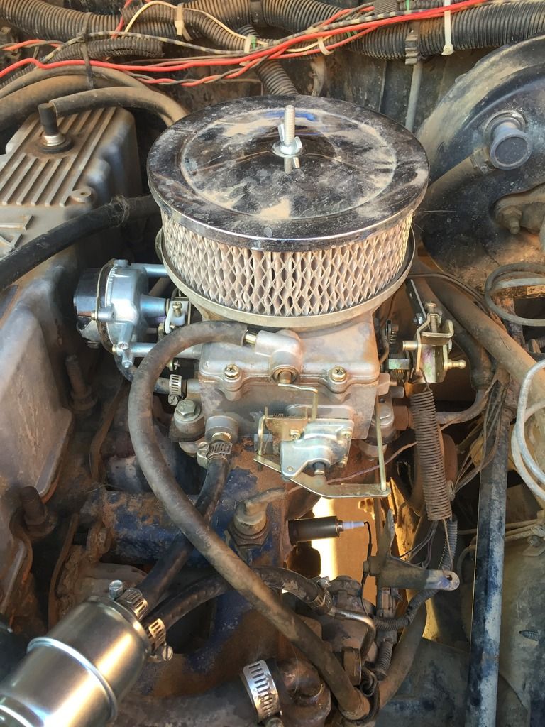

Idles smoothly at around 1200rpms. No sputtering, etc. Revs up nicely as well, but won't hold. Again, I'm new to carbs, so a little unsure of what I'm looking for, but I'll describe what I'm seeing.
-pull air cleaner, choke is functional
-watch acceleration jets while manually revving engine. Both jets immediately respond to acceleration with a nice steady stream into the Venturi. If I hold manual acceleration, should fuel continue to stream out of the jets? (It doesn't). After a few seconds running at higher rpms, it bogs down. If I let off, it will return to idle; if I don't let off, it kills it.

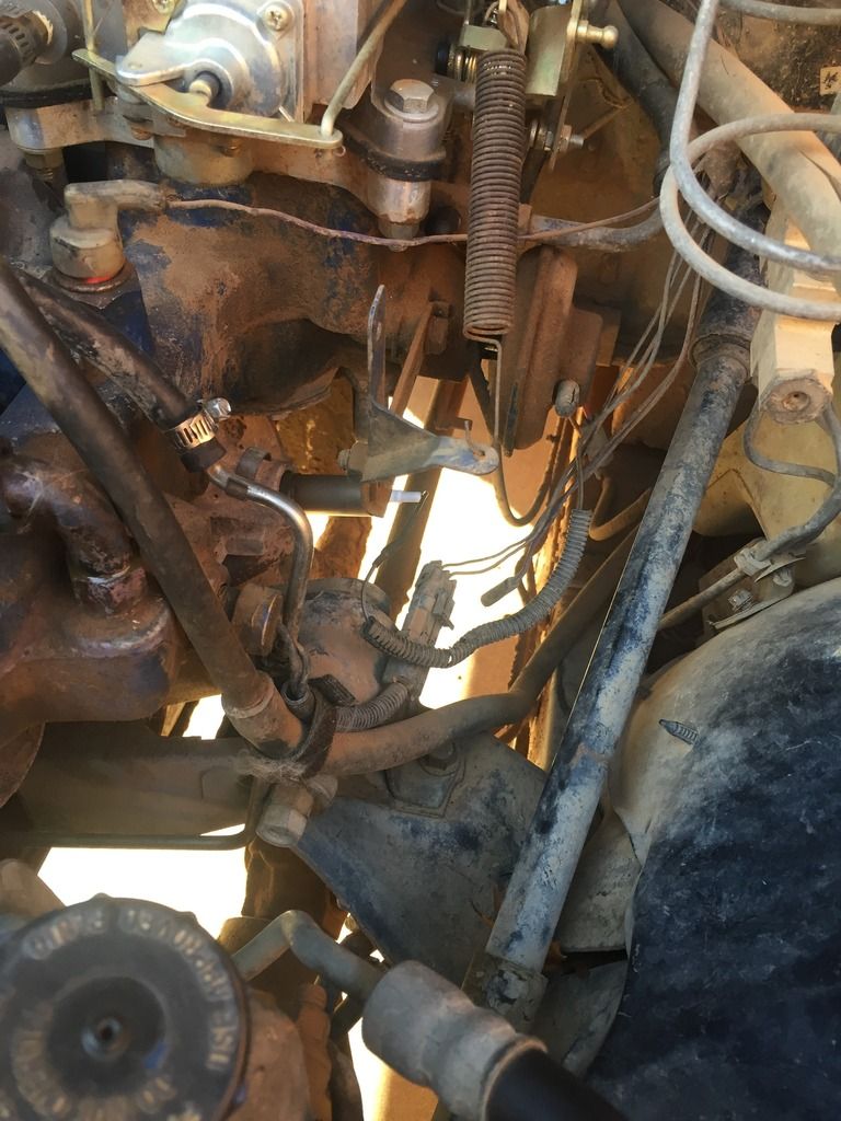

I'm hoping a carb guru will chime in here. That's not the stock carb, but I don't know what it is either, I tired of mine and went FI.

Well, im damn good with carbs.....but not a guru. Sounds to me like the float is to low, and the bowl is running out of gas. Do a test for me. It idles.......how does it run if you hold it to the floor for an extended period? get it in gear, and floor it for at least 10 seconds IN GEAR.If it runs ok floored, but not half throttle, its a failing power valve. Is it a webber carb?....ive seen these with the fuel inlet and return line switched...( if yours has a return line) and it will idle, but the bowls run empty fast as you can imagine. Try that test, let me know how she does. Also spray carb cleaner around base of carb at idle, and at manifold to head......if the spray causes a change, its a vac leak.

Look up motorcraft 2100. I know there are threads about tuning that carb. You might check that the nutter bypass has been done as well since that carb is not computer controlled.
