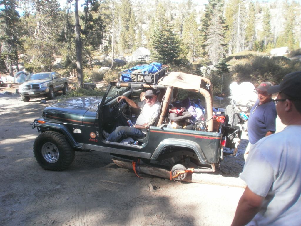

While this is true........ how many guys running 8.8's have you seen like this?
I haven't, that's why I'm asking. I have seen this several times with the 35 though.

While true (to a point) the 8.8 is considerably stronger than the 35 so it's less likely (than the D35) to break in the first place...
and if/when it DOES break - while not an ideal situation, it is possible to hobble it off the trail as the caliper (for short term) will keep the axle from coming out.
