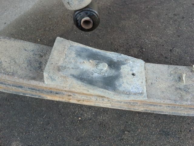

ubolts, center pins, spring perches, and spring plates
Super beef spring plates from Ironman Offroad. 30$
half inch plate steel for homemade spring plates 8$. I was going to buy them but they were going to run me over 40$ so I figured why not make my own for a fraction of the price and over twice the strength.
all 10 holes drilled with regular hand drill.
old vs. new
