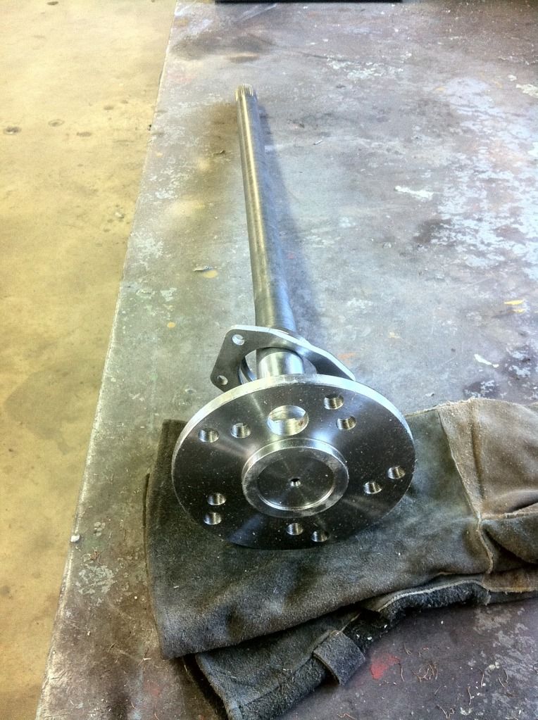

Drum brake 8.8 explorer axle shafts are 1/8" longer on each side than disc brake axle shafts. Fact.
With such a minute difference, I would think you could utilize disc brake axle shafts as spares right?
I'd assume that prolonged use would be bad because the drum wouldnt fully cover the shoe and create a groove?
Just food for thought...

When you look at how much spline is in contact with the carrier that little bit won't matter if you can get your c clips in there.
They're stout shafts.

Hmm, yea, the shorter length could make C-clips an issue or maybe require the s-spring removal if LSD.
strength is definately not an issue.
I was thinking of the drum brakes the wrong way, they may actually hit the backing plate without a spacer.
