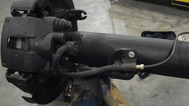

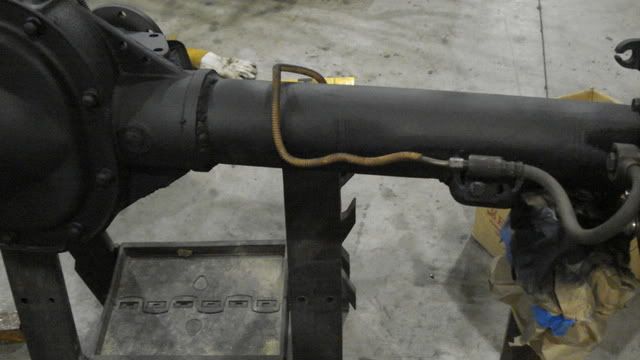

Regardless, you'll need flex lines right at the calipers. The calipers "float" on the mounts as the pads wear. Flex lines at the calipers are a must.
There is no "only one way" to do it. Here's how I did it, choose your favorite way of doing it.
I just installed an 8.8 in the wife's SOA '93 YJ last week. I used the stock YJ flex line & junction block and mounted it to the axle with the original YJ bolt/vent line fitting. I used a 12" inch long 3/16" hard line on the left & a 40" long 3/16" line on the right & attached them to the calipers using 2 right side Ford 8.8 flex lines. I drilled a hole & welded some nuts to the backside of a section of angle iron for flex line mounting points which were welded to the spring perches.

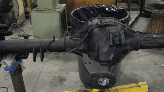

Here's what I did. I don't think any one way is better so here you go.
Lou

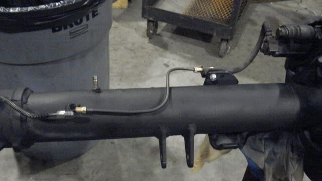

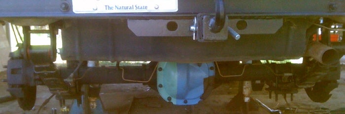

since we're posting brake line p0rn
