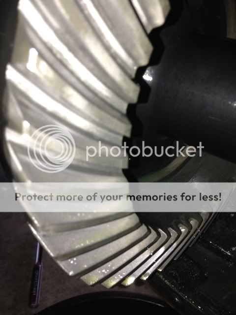

What kind of stuff do I need to check the gear pattern? I have put some miles in the spool now along with a wheeling trip with no problem but I plan on a 4 hr trip in the jeep at the end of this month so I pulled the diff to check it out. There is a little fine metal shavings in the fluid but I reused it last time I had the cover off and I am prettying sure those came from taking the old spartan locker out in favor of the spider gears. But here are a couple pics of the gears......
Ps that tooth on the ring gear was ground down to install the old cross pin!

You'll need some marking compound to check the pattern, if you decide to do that.
Frankly I think the advice to check the pattern is conservative, but I'd do it were I in your situation just for peace of mind.
