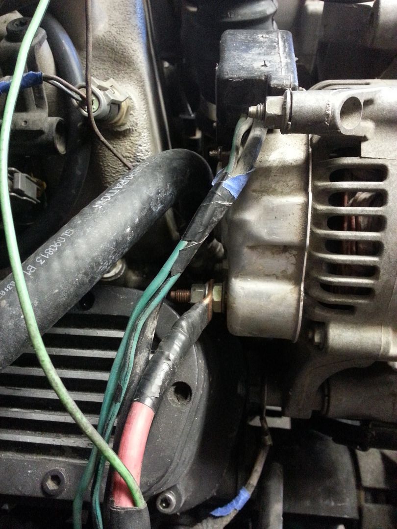

While I have you Skyj, how is your alternator hooked up?
Mine has this 4 way bolt on thing with wires going to it. Then this bolt/nut with a black boot around it. I think a B+ wire goes to the black boot and that's it but I have a ground wire from the pdc that is labeled alternator and I can't remember where it goes.
Here is a pic of mine. The ground wire form the pdc goes on the fartherst post closet to the thermostat housing and the B+ from the pdc goes to the big lug on the back closest to the valve cover hope this helps. The greens are the black boot thingies that bolts to the small lugs on the top of the alt.
I think I got the jist of it, thank you!
