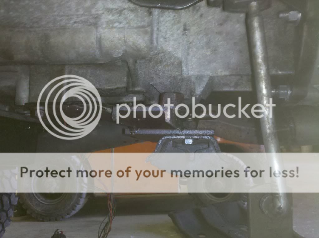

well heres a pic of the trans mount its not the greatest but basicly all I did was use the mounting plate that was used on the trans from the GC and welded a small piece of c chanel than some 1/4" plate and drilled it for the wrangler mount
