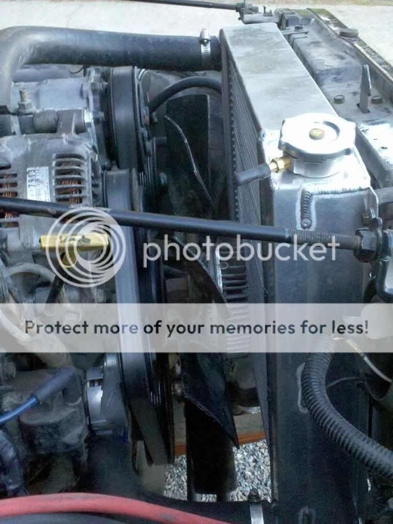

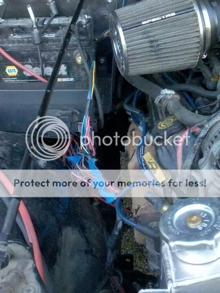

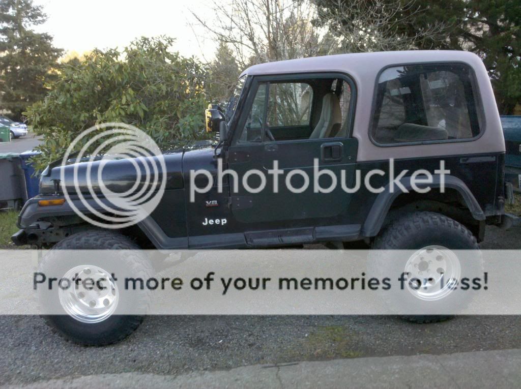

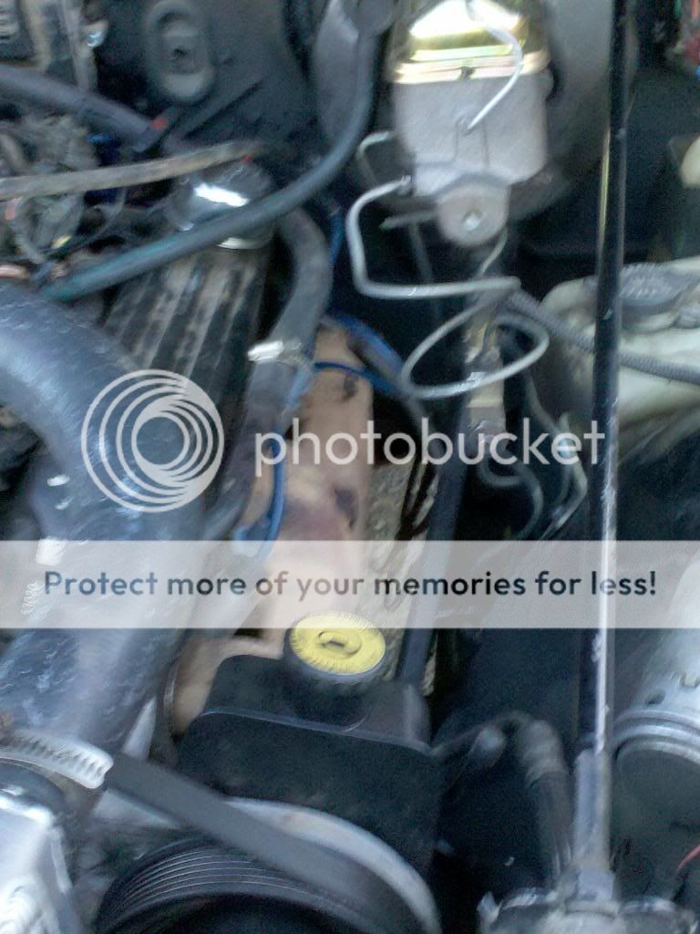

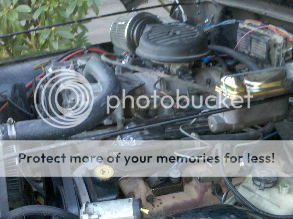

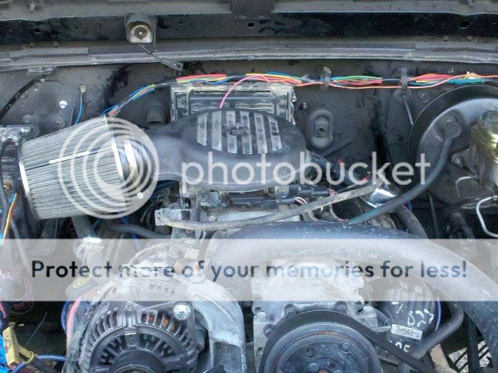

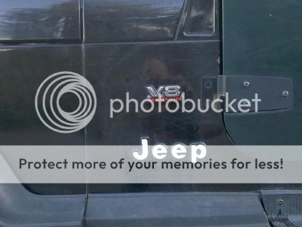

update & more pics
Well as promised heres some pics of the finished product. after a day of driving no problems to report. everyting is working perfectly and couldnt be happier with how it turned out. if everything is still good in a week or two Ill go back and loom up the wiring.
feel free to comment or ask any questions.
