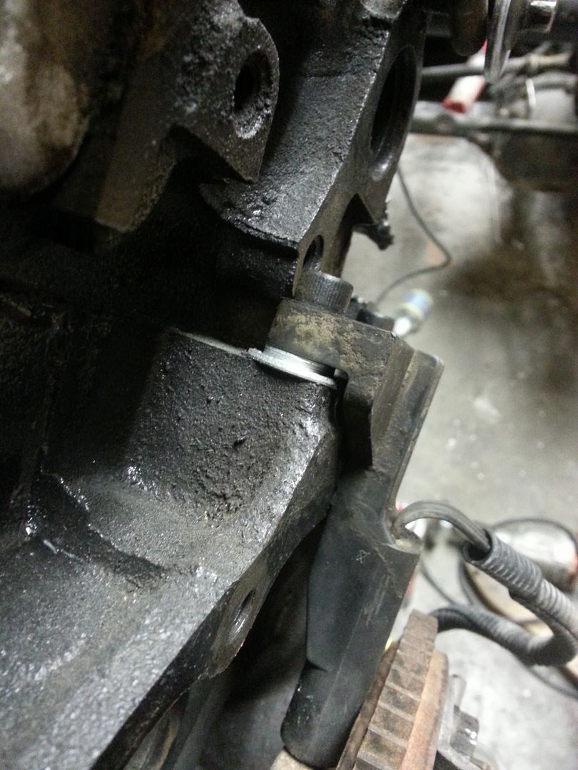

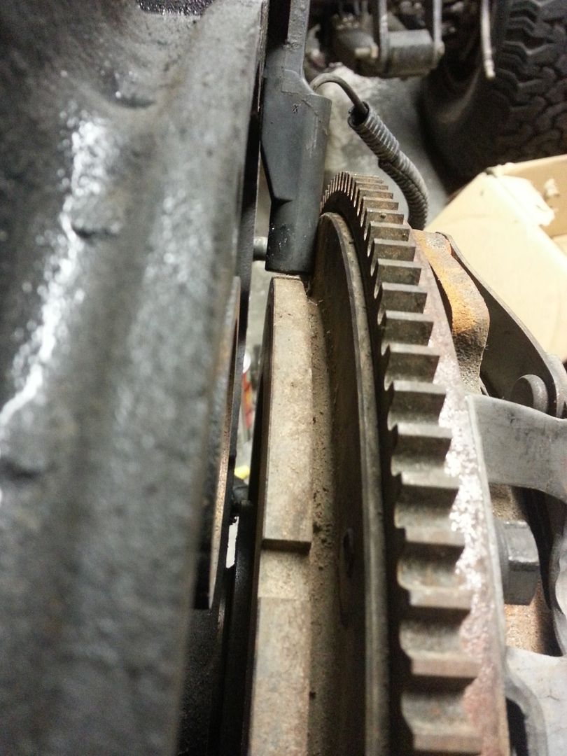

Messed around with the auto cps today I used a piece of cereal box cardboard as a spacer between the sensor and tone ring
Then used three washers as spacers to the block mount.
I spun the motor to see if there is any contact and it looks fine. Anyone know if this wont work? its not too hard to get to now that the motor is mounted so if I have to swap it out its not that big of a deal.

I just want to add the cps info. When I did my swap, I used the Dakota 3.9 manual sensor when I took the bell housing. It fits and works perfectly.
