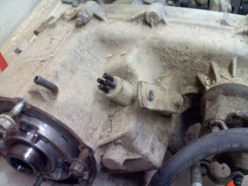

So last week, my XJ finally gave up the ghost. Fortunately, a YJ stepped in to fill the gap. I've spend the week fixing a few obvious problems - a botched clutch install, dry rotted tires, basic Idiotic Former Owner [IFO] stuff - but there's one thing I haven't been able to figure out: the 4x4 engagement lever doesn't move. My first thought is that there's something wrong with the transfer case or linkage, but I'm coming from a 92 XJ automatic to a 94 YJ manual, so I thought I should check my bases.
All I should need to do to change into 4H is pull the lever straight back, right? And I should be able to do it in neutral, or while in gear and driving, just like my XJ, yes? I don't need to, whatever, push a button or pull the lever upward or something?
Assuming I'm doing everything right, what's next? Look up between the TC and the tub to see if anything's in the linkage? Visually check over the function of the TC? Can I just unscrew the transmission access panel in the passenger compartment and look through there?

you can see the linkage my simply going underneath. You should not have to pull up and push down on the lever at all. if you disconnect the linkage you should be able to shift the tab on the case by hand. it will be hard but possible to pull the tab toward yourself.

Yeah, that's...definitely stuck. Inside the TC, as far as I can tell. So the only next step is getting the TC off and either replacing it or getting into it, yeah?

I was not kidding when I said it would be tough to move. that being said... if you can disconnect the linkage and then move the t-case shifter freely... then yeh its stuck inside the case.
luckily its quick and easy to remove + not too heavy. drain, unbolt that sucker, disconnect the vac lines, pull the rear shaft, and pull it out. As jeep parts can go, t-cases are a dime a dozen and worth about 75 bucks.

And, conveniently, I happen to have a 92 XJ 4.0 sitting right next to it, with a dead transmission, that I'm thinking about parting out anyway. They're both NP 231s, if I recall? And the TCs would be identical otherwise, yeah, even though one's a manual 2.5 YJ and one's an automatic 4.0 XJ?

You'll have to change the vacuum switch and the front driveshaft yoke(is that what it's called? the part that bolts onto the transfer case for the driveshaft to attach too....haha). That's different on the XJ. If you pull the one out of the XJ first you can count the splines, not sure but the one for the 4.0's may have the higher spline count....can't remember if it's 23....I'm sure somebody can chime in with more accurate numbers, I'm just going from memory
