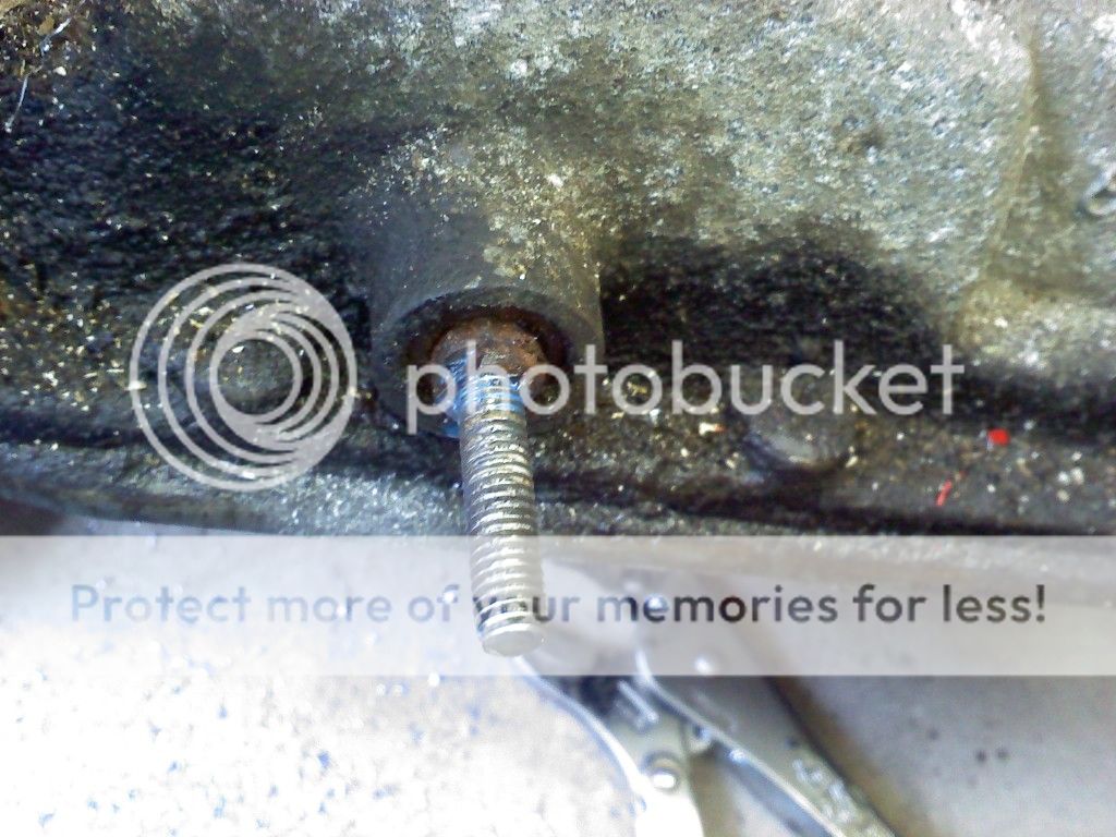

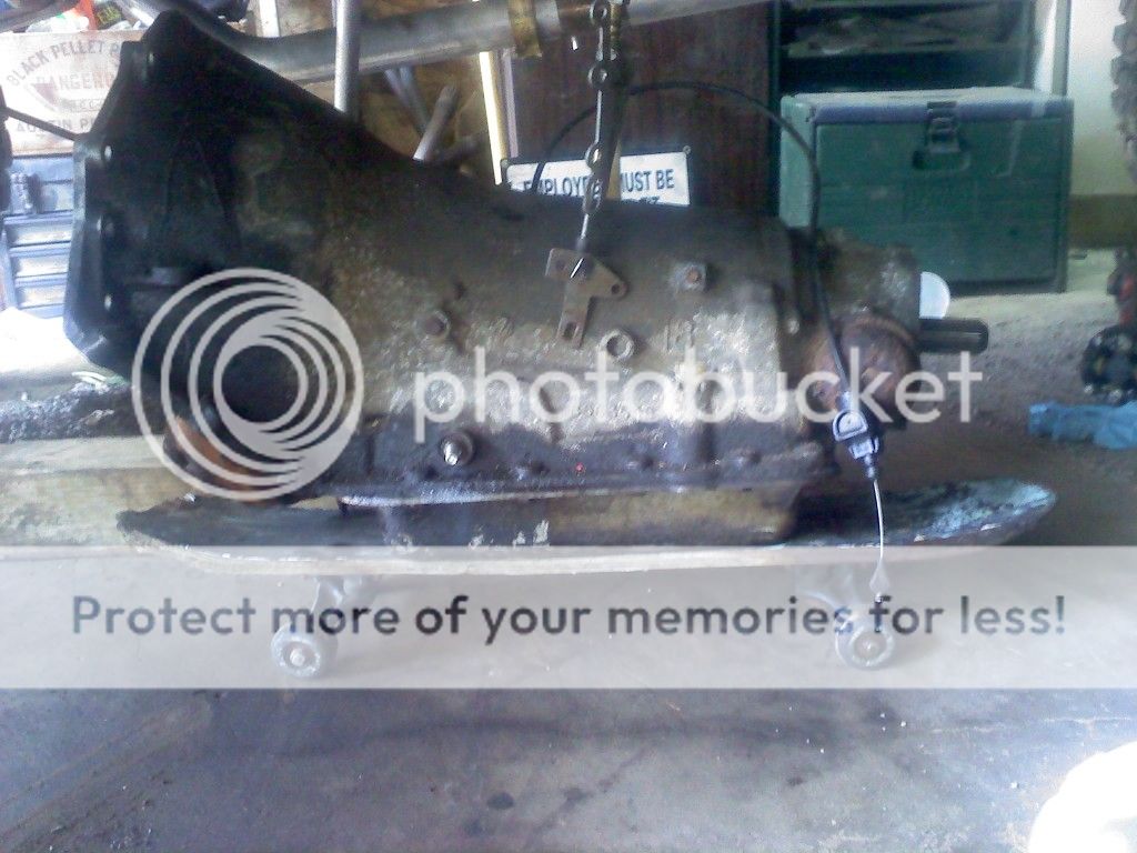

Hoisting the trans . Couldnt find a jack tall enough
Seperation. Wow those bolts were tight. Surprised nothing snapped

Trans is in
Moved the trans into place
Raised it up and installed it

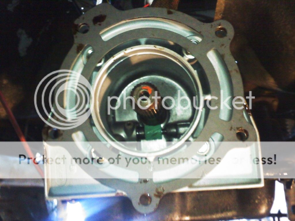

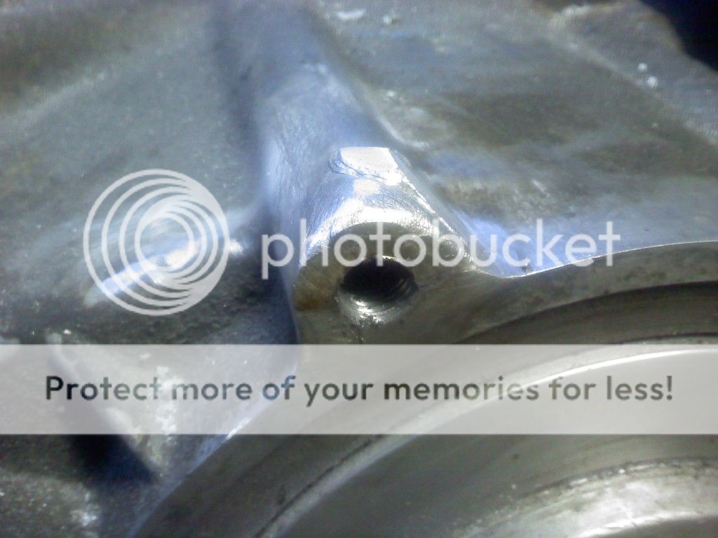

Had this problem again but i was ready
A friend stick welded this for me . Its on the transfercase
I think this is gasket number 5

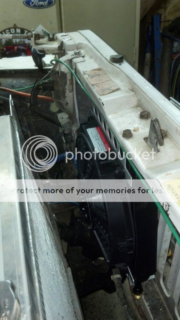

Still having tranmission cooling issues running at 240 on the highway with 2 trans coolers at work
