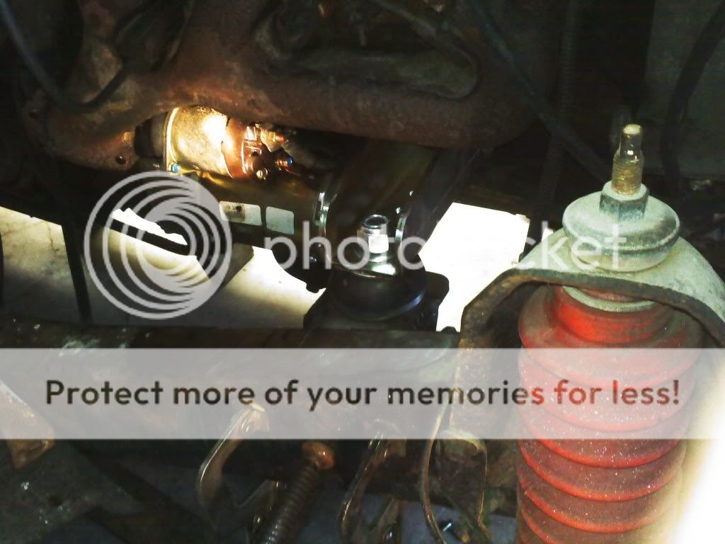

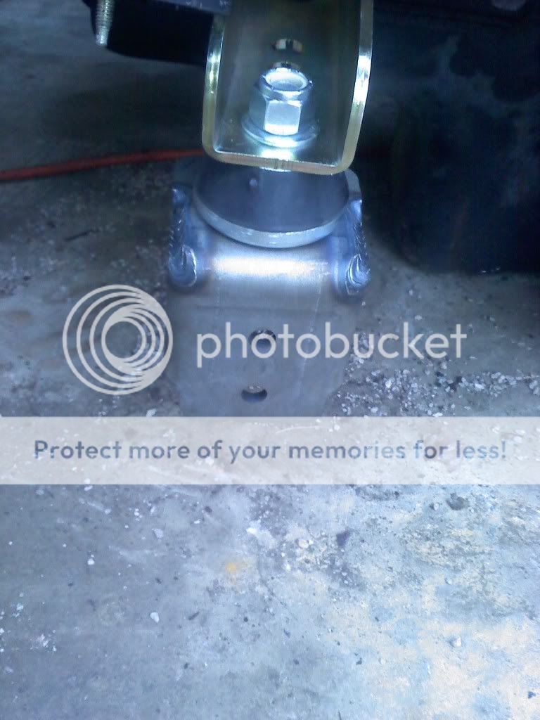

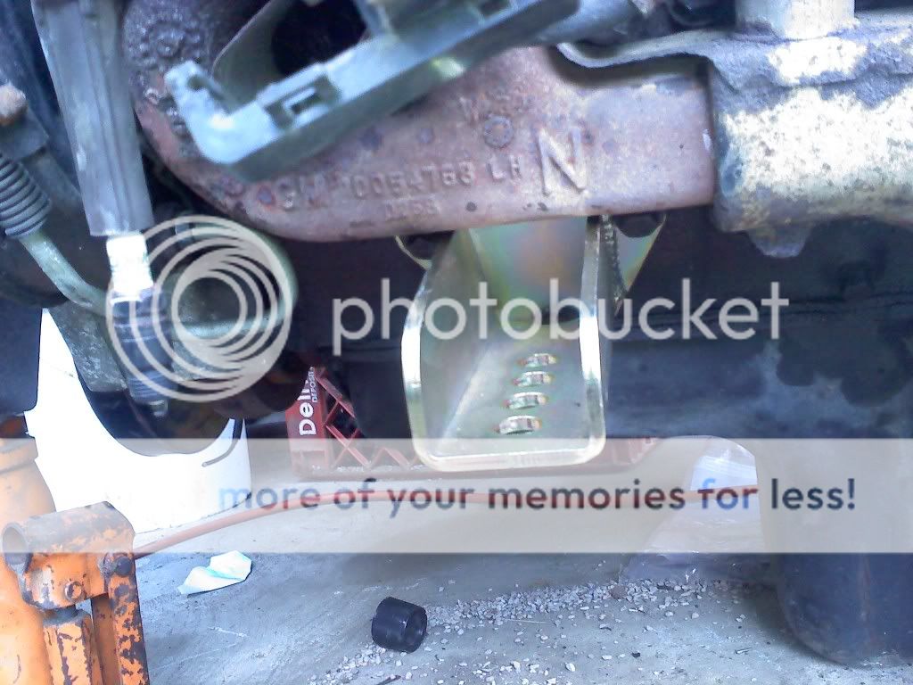

This is it for today. Just picked up the motor mounts and clamped one on

YJames90,
Make sure of your measurements. With my 4.3, I used the mounts in the opposite way. This allowed the engine to sit lower in the frame, which gave me plenty of space for everything. It probably won't make a big difference, just be sure of your measurements. I can't wait to see how your project will turn out! I hope the photos help.

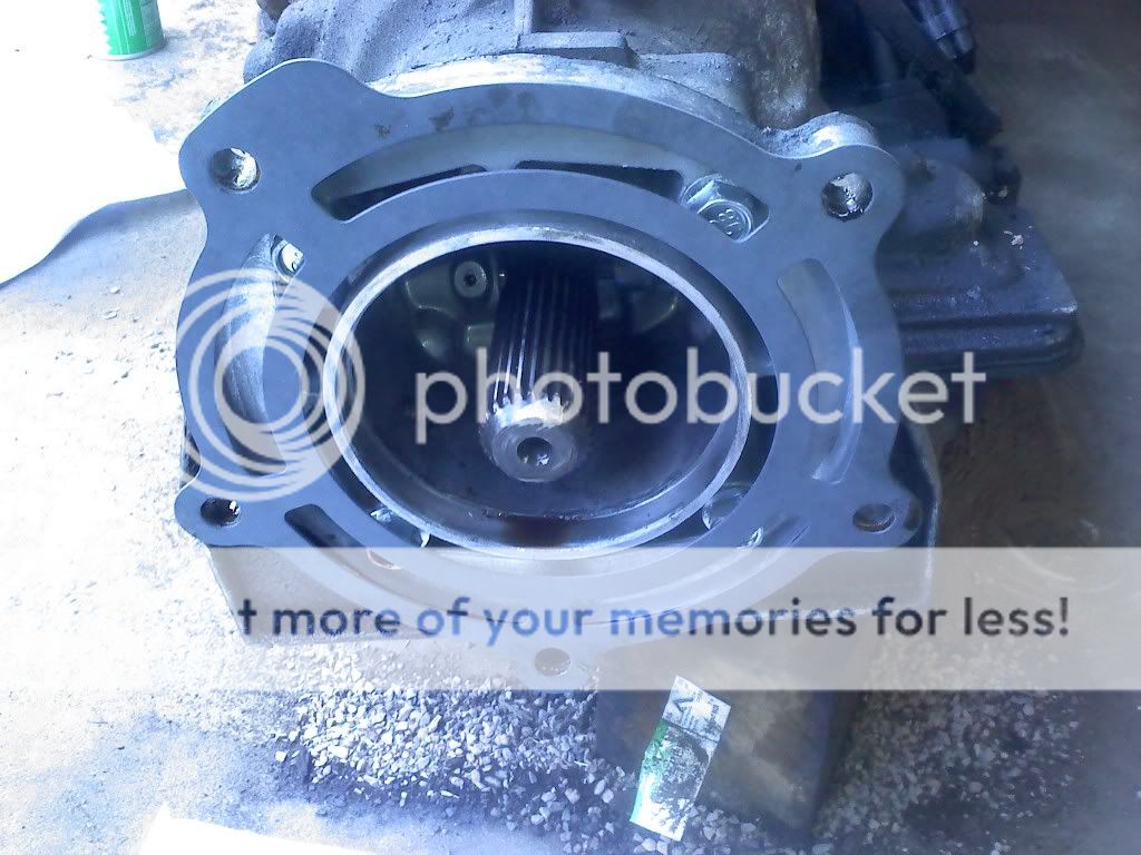

Actually I had planned to do that tonight. First I have to go to the Chevy dealer to get the gasket that goes inbetween the trans and TC. The actually have 2 in stock.

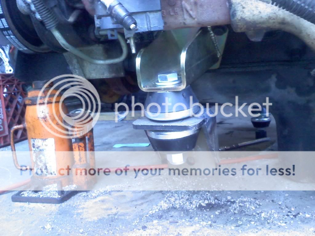

I think Im down to almost last of the grunt work.
Fenders are off
Motor mounts are on
Bolt in wrong way
Bolt in right way
Gasket on
Ready to go in tomorrow
Thats it for tonight

James, I did just what you did for the filter. There are two filter styles for that motor, a larger 4wd one and a shorter 2wd. I've used both over the years (did my swap in Nov '04). I tend to use the larger one normally.
I see you have a steel oil pan. Mine is an aluminum casting, which fortunately I've never hit on a rock. The bolt patterns are different or I would have switch to steel.
You have the same mount as I used. The 1/4" lowering of the motor I had to do was done by shaving 1/4" of the rubber on the top ones.

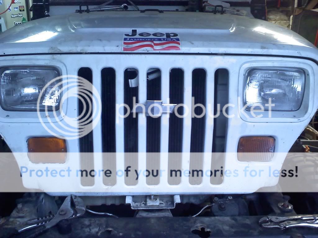

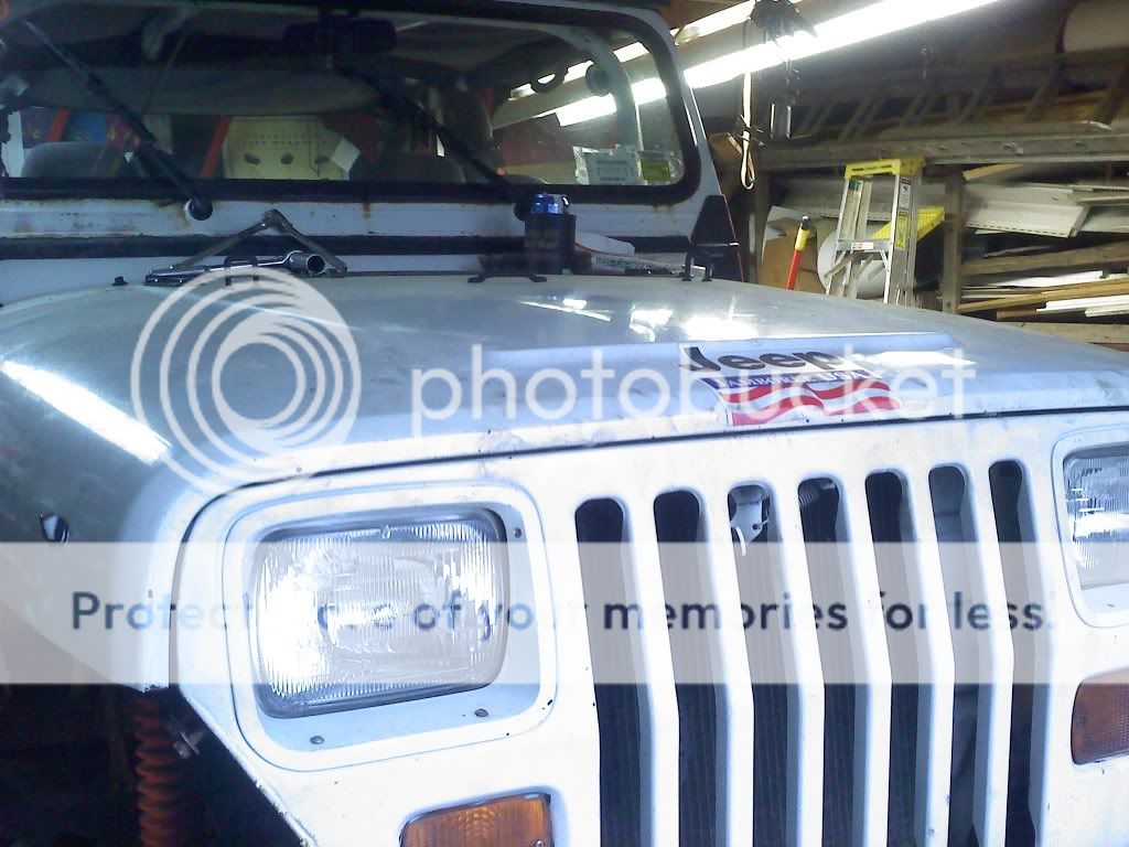

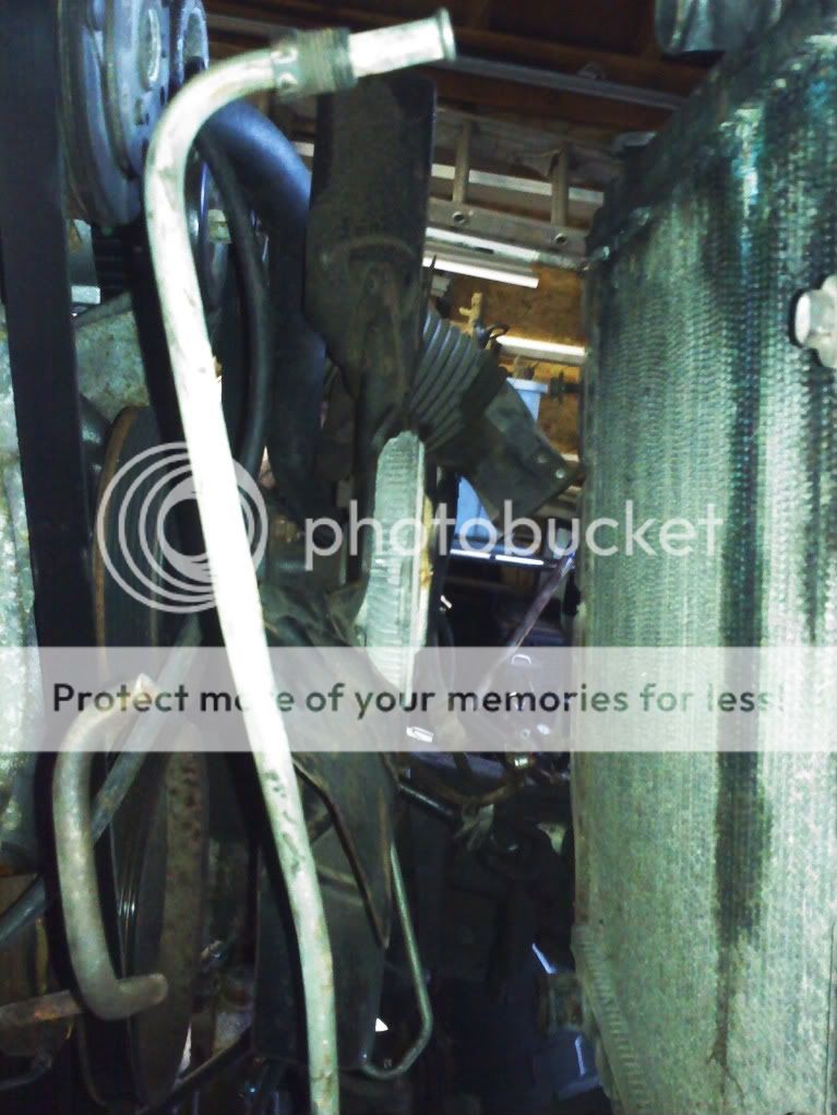

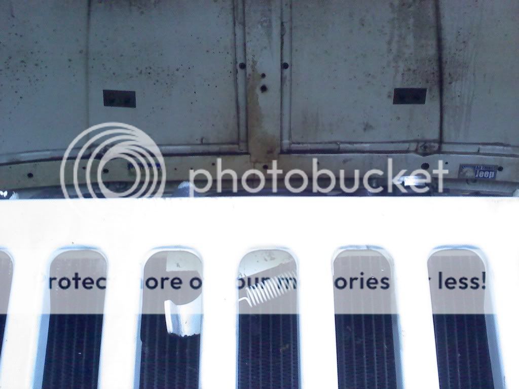

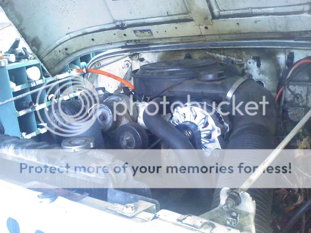

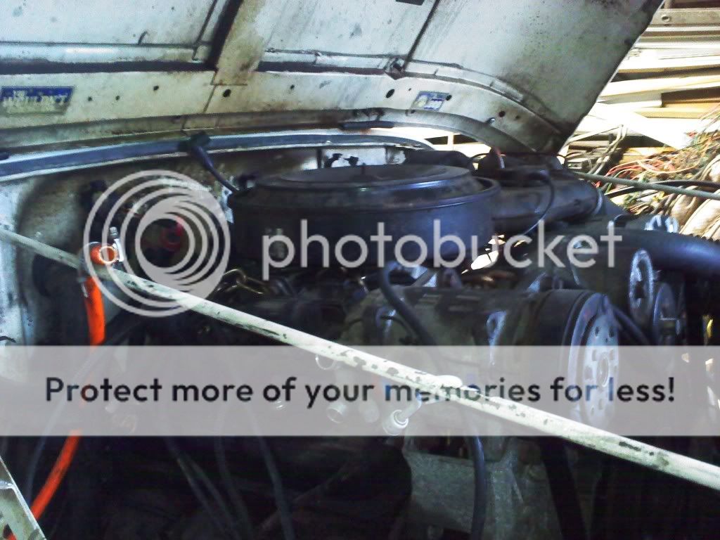

Lets just start by that I am exhausted! Have been out in the garage since 9:30 am and skipped lunch.
The 4.3 is now clamped in by the motor mounts to the frame in and will be welded in tomorrow
Perfect hood clearance
Good radiator space
Hood shuts
Chevy!!
Some how, Im not sure but both drive shafts fits perfect. Maybe because I an stretched an inch front and rear on the axles
