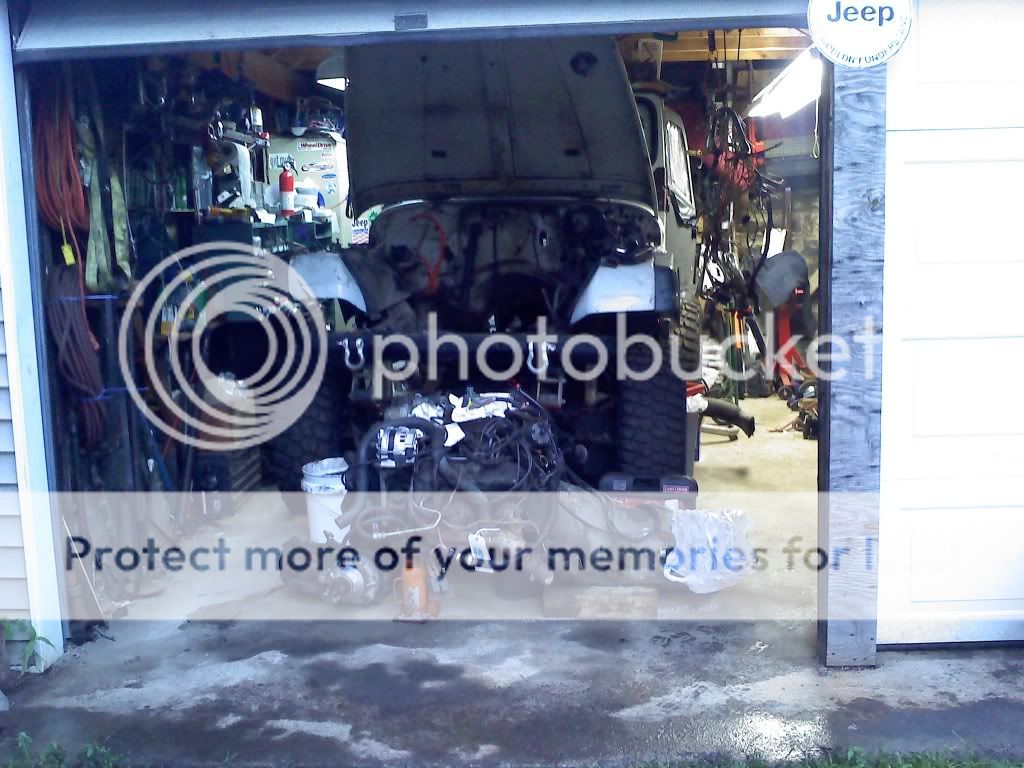

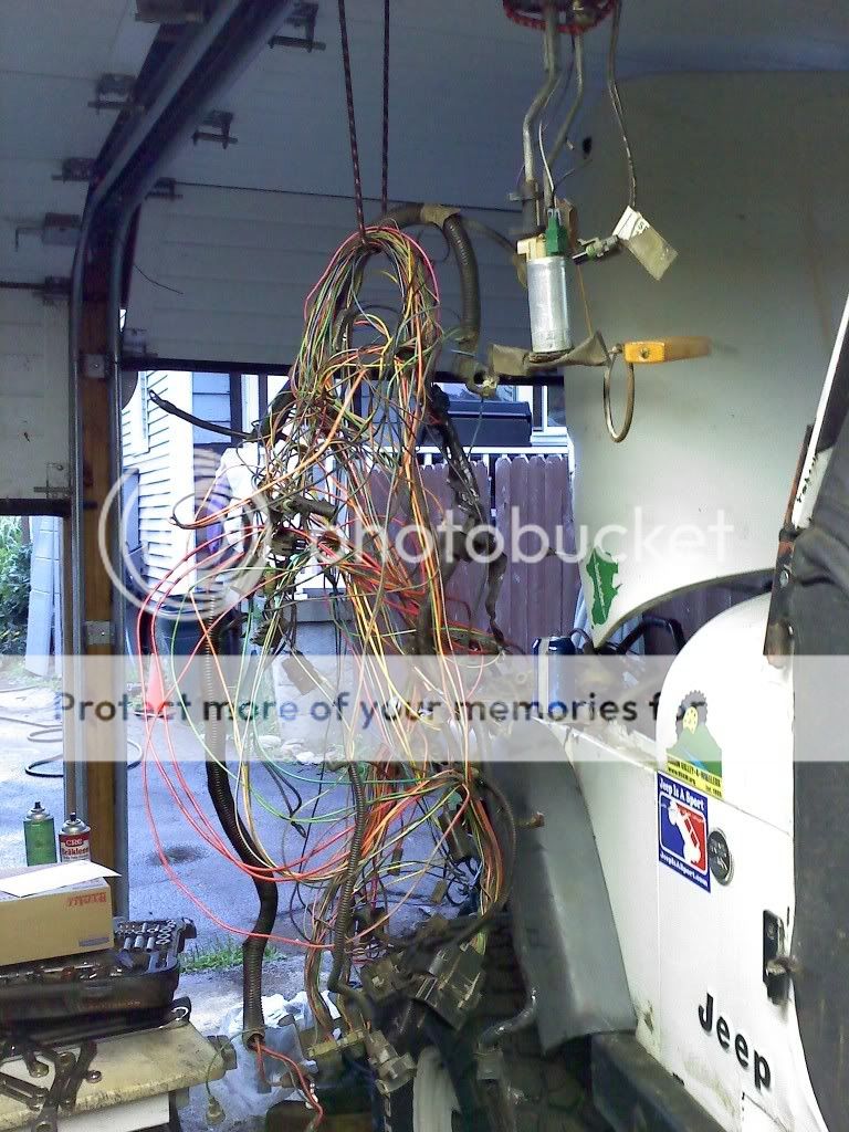

Little progress today. Mostly pictures

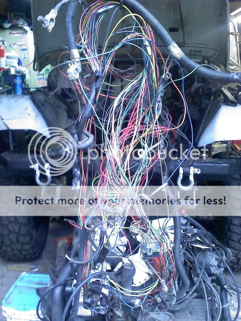

Removed the harness
Hanging next to the S10 fuel pump

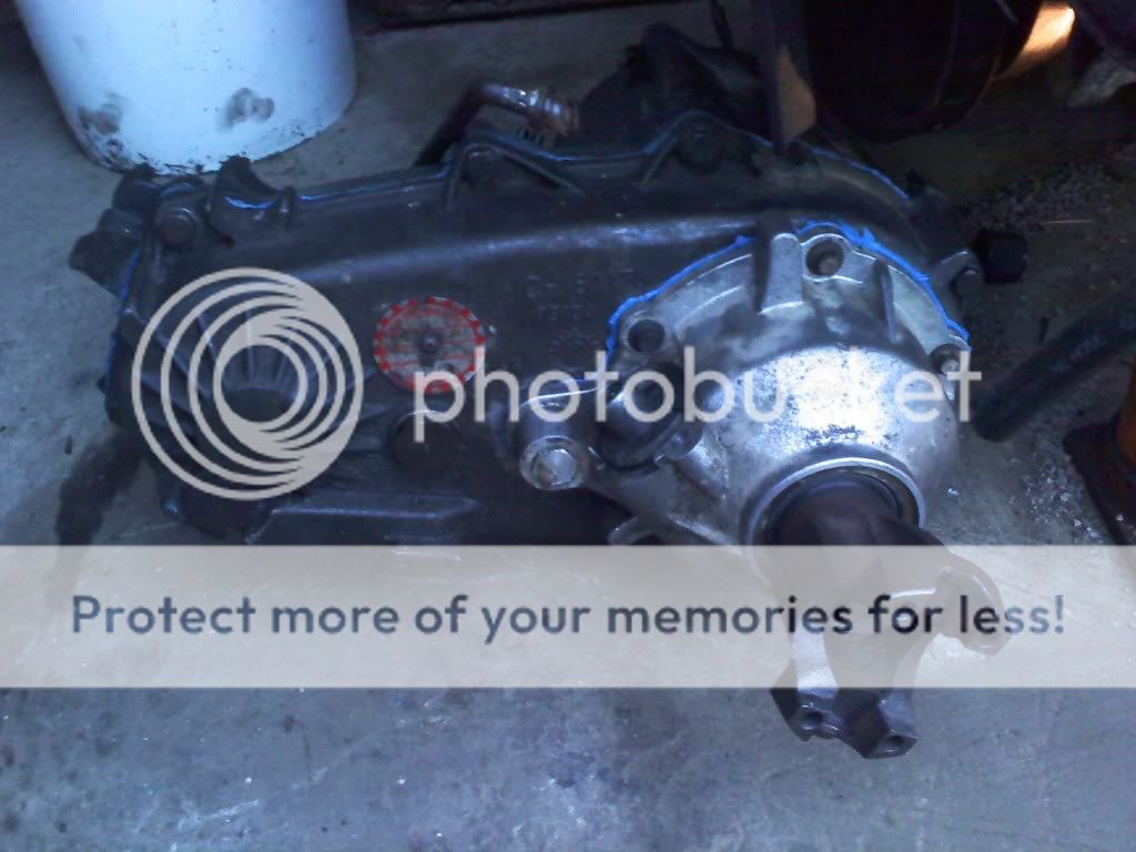

Transfer case done

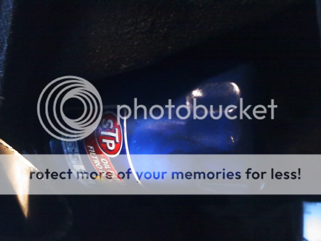

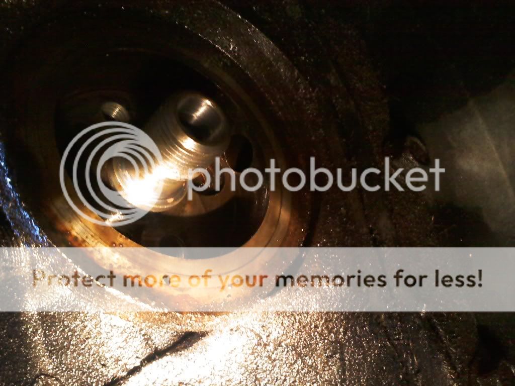

Filter fitting screwed in
Filter on

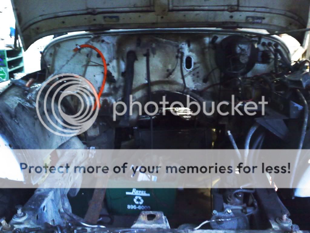

Empty bay
Work in progress
