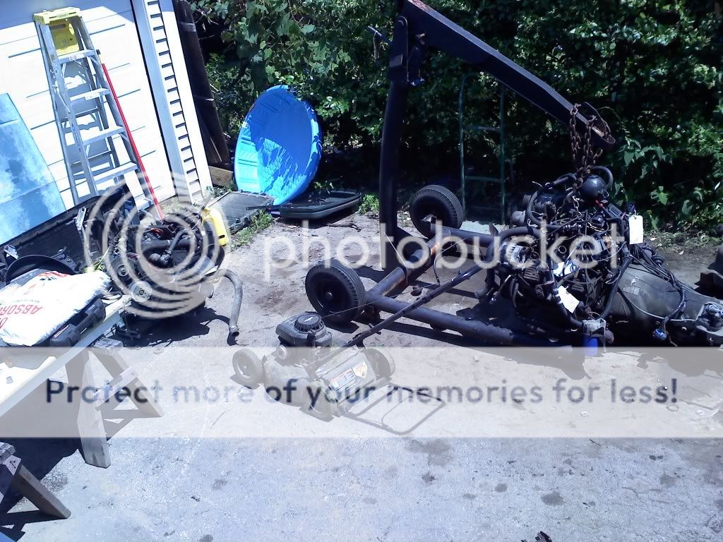

The motor is out and waiting to go in the YJ
Waiting to go in

Going to need half of that transfer case

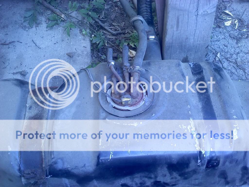

Planning to use the S10 fuel pump

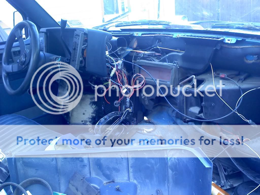

Only swap work today was weed out the scan tool port on the S10 wired from behind the dash, Its nice using a crow bar to pull the dash instead of inbolting it

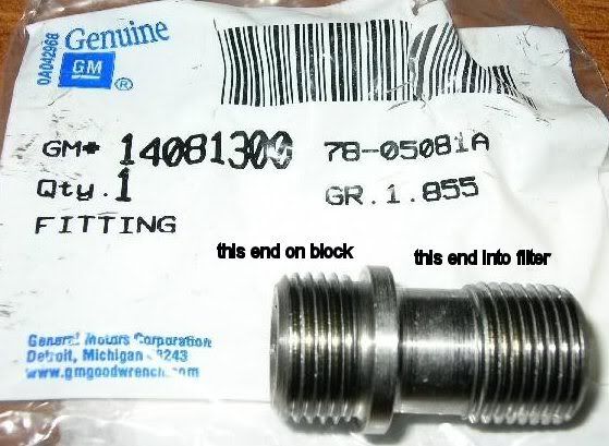

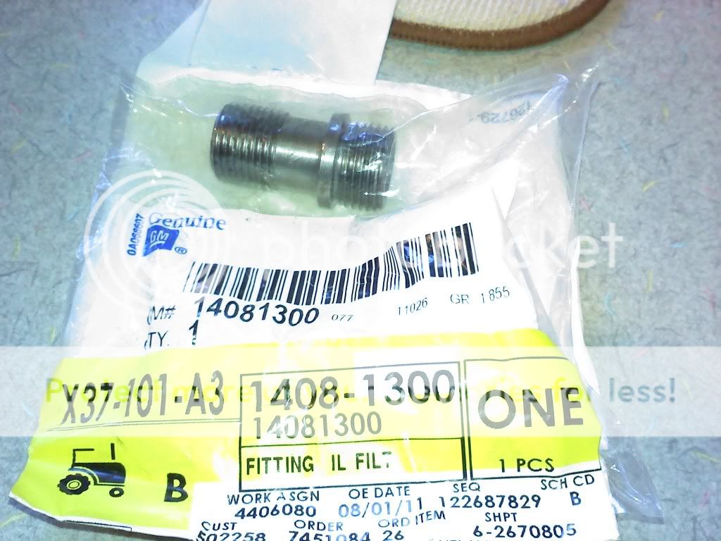

Ordered the oil filter relocater nipple from Chevy today and should be here on Tuesday

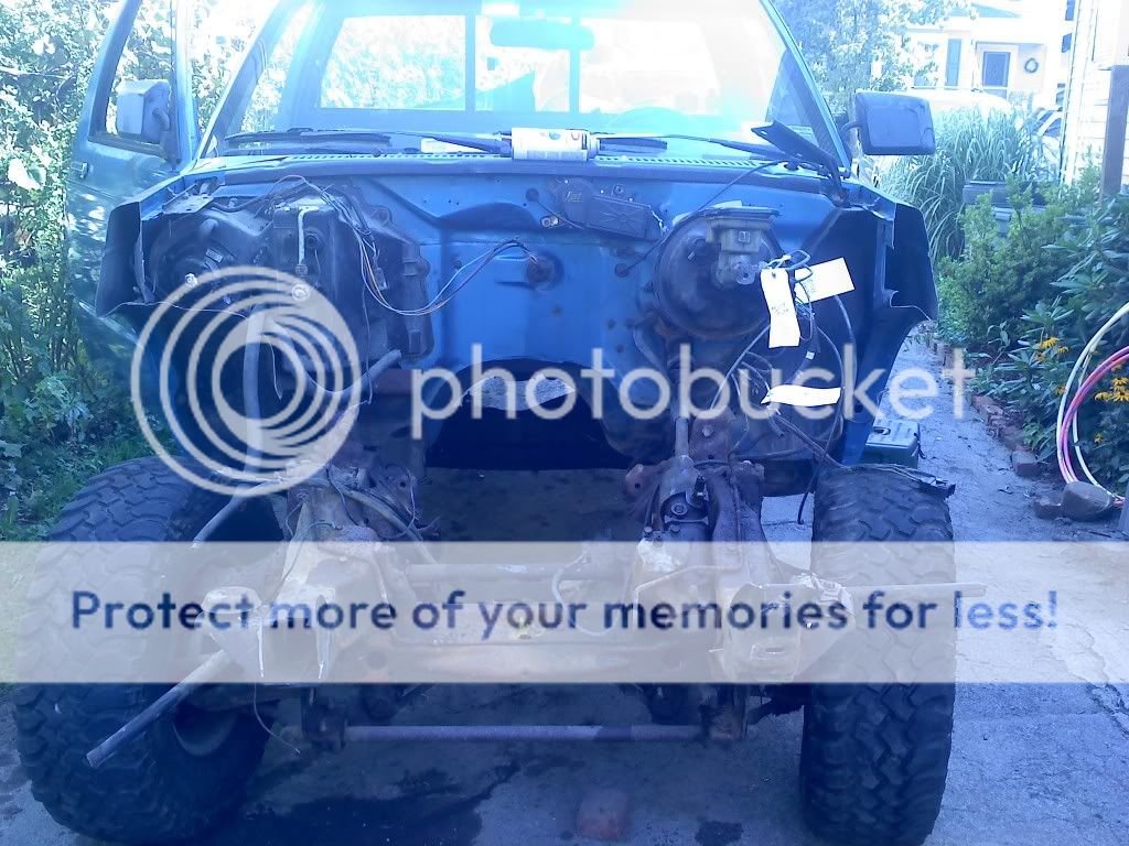

Thanks for the heads up on the mounts. Made more progress today.original yj frame mounts are cleaned off the computer harness is out of the fire wall. Started to separate the looms but have to do some more reading on what to keep.would post a picture but can't figure out copy paste on the wife's I pad.she's in the pool playing volley ball so I can't ask her

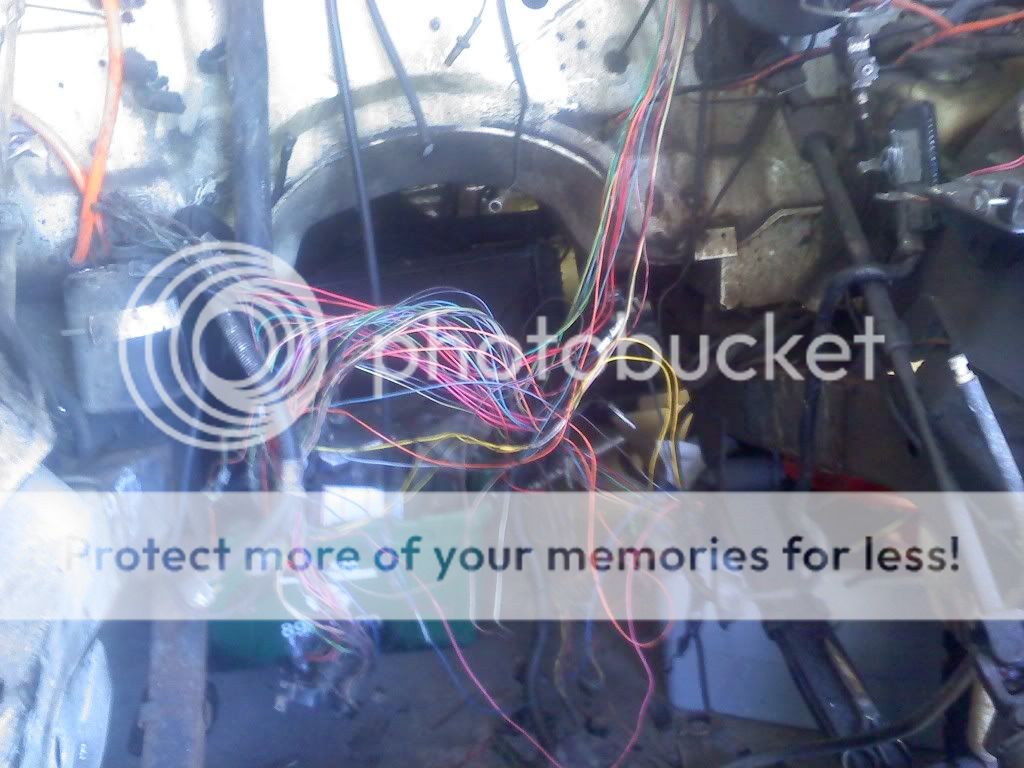

Heres where Im at now

OMG! hopefully its not but that looks terrifying Im wanting to put my 350 in my Jeep before to long and that doesnt look like fun

Cool swap James!
The wiring is the easy part
Step 1 is finding the bulkhead diagram for your year and engine.
Next unbolt bulkhead connector from the firewall on the engine bay side (actually you remove it from the back of the fuse block under the dash). Pull back the loom and crap from the engine bay side of the bulkhead connector. You will see that it is two halves. One half (right side) goes to the lights. Remove this and set it aside with the grill. Nothing here changes.
Next is the left side. This goes to the battery, engine, pcm, and underhood fuse block. It's easier to remove this and set it up on a table than it is to try and thin it out on the firewall. Start by pushing the pcm connector through the firewall (none of this will get re-used obviously) then unplug it all and lay it out on the table.
Refer to your bulkhead diagram and remove what is unnecessary. Basically you keep all the bus circuits (powering the alternator and under-dash fuse block) gauge sending unit wires (for your dash), alternator wires, coil power, PCM power wires, and the starter solenoid wire. There's some others but it's been a while and I can't remember. If you get me your bulkhead pinout diagram I can tell you exactly what to keep and what to remove.
Also, keep the water temp and oil pressure sending units from your 4 cyl engine so you can put them in the 4.3 and keep your factory gauges.
Once all the factory engine wiring is removed, you can start on the S10 engine harness. That's pretty easy too.

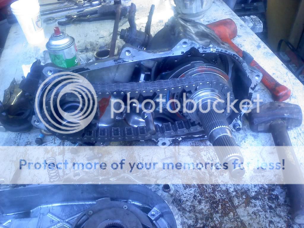

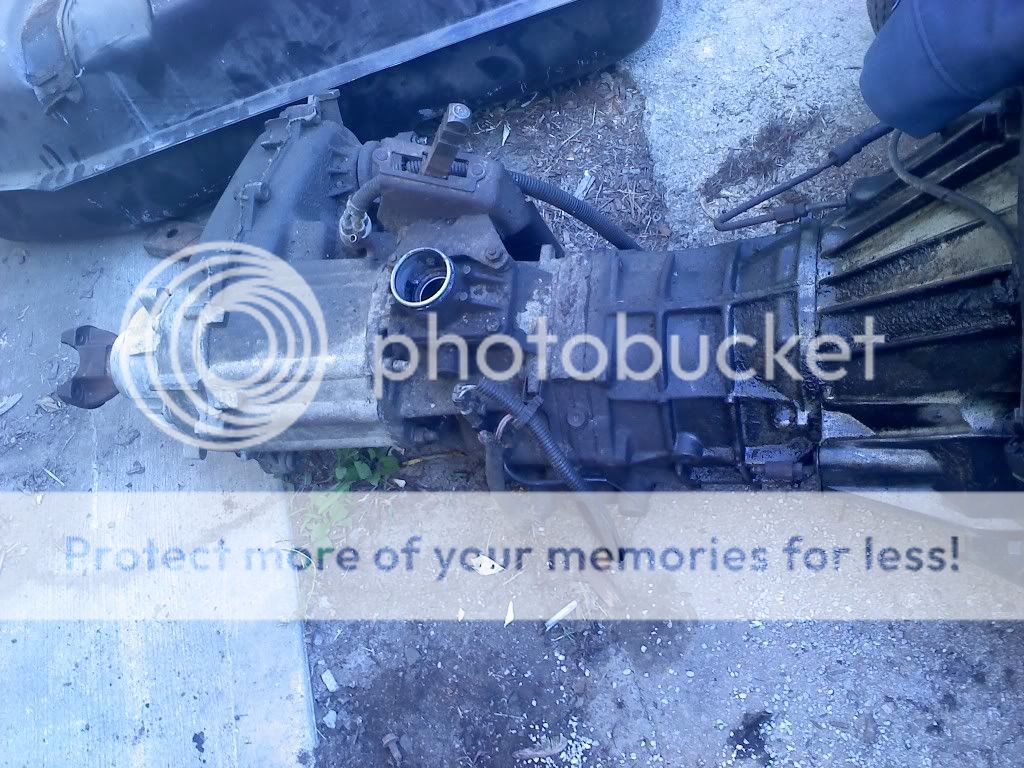

Another day and more progress.

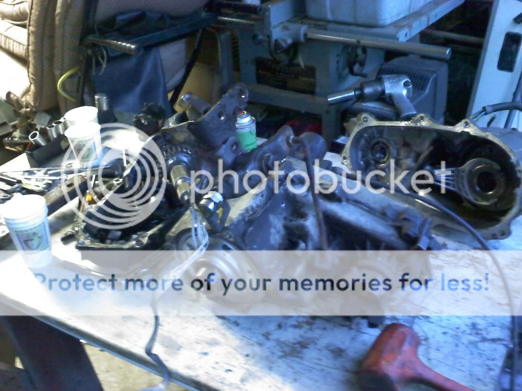

I split the YJ 231 that had the SYE in preperation for the other half of the NP of the 231C
Looks like a mess but its under control
Getting the motor out from under the Jeep was a bigger job that you can imagine. Even though it was on the floor tucked under the front axle. Bad idea as I had to pull it out to remove the transfer case
Now it sits waiting for the TC and the oil filter nipple. Tomorrow?
My plans are still to burn in the AA motor mounts and have the motor in the Jeep by Sunday. Moving fast. I have twins that will be 16 next month and want to drive.
My 2.5 to 4.3 swap thread
YJames90 is offline
post #28 of 1069 Old 08-01-2011, 09:32 PM
MikeBK
Location: Dobbs Ferry, NY
Posts: 544
And you have to be at trailfest by the end of the month
Consider Obama the lesson many in this country need to learn, the rest of us just have to pay for it!
MikeBK is offline
post #29 of 1069 Old 08-02-2011, 09:01 PM Thread Starter
YJames90
YJames90's Avatar
Location: Dutchess County, NY
Posts: 6,997

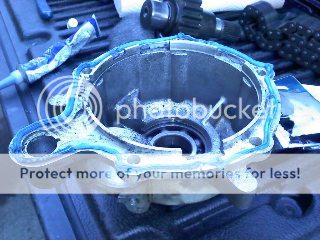

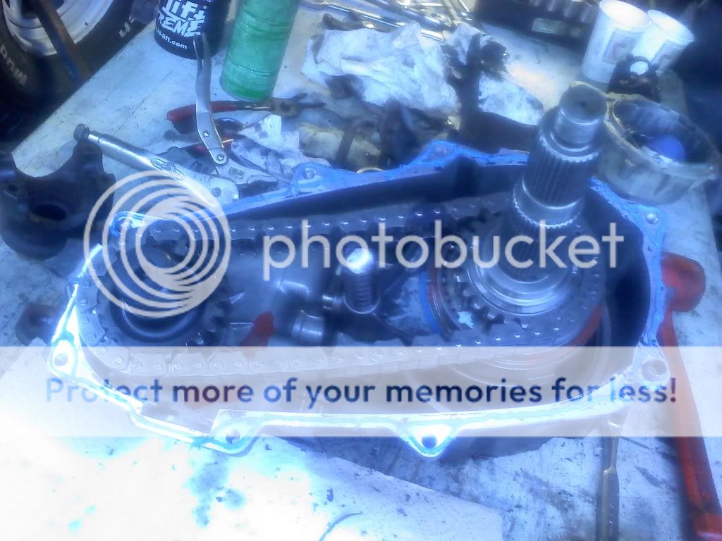

231C & 231J are now combined with the SYE installed. Hardest part was keeping the pick up line in place when reassembleing.
I kept the YJ chain in but am also keeping the chevy parts as a spare.
THe job took around an hour as I had both TCs out

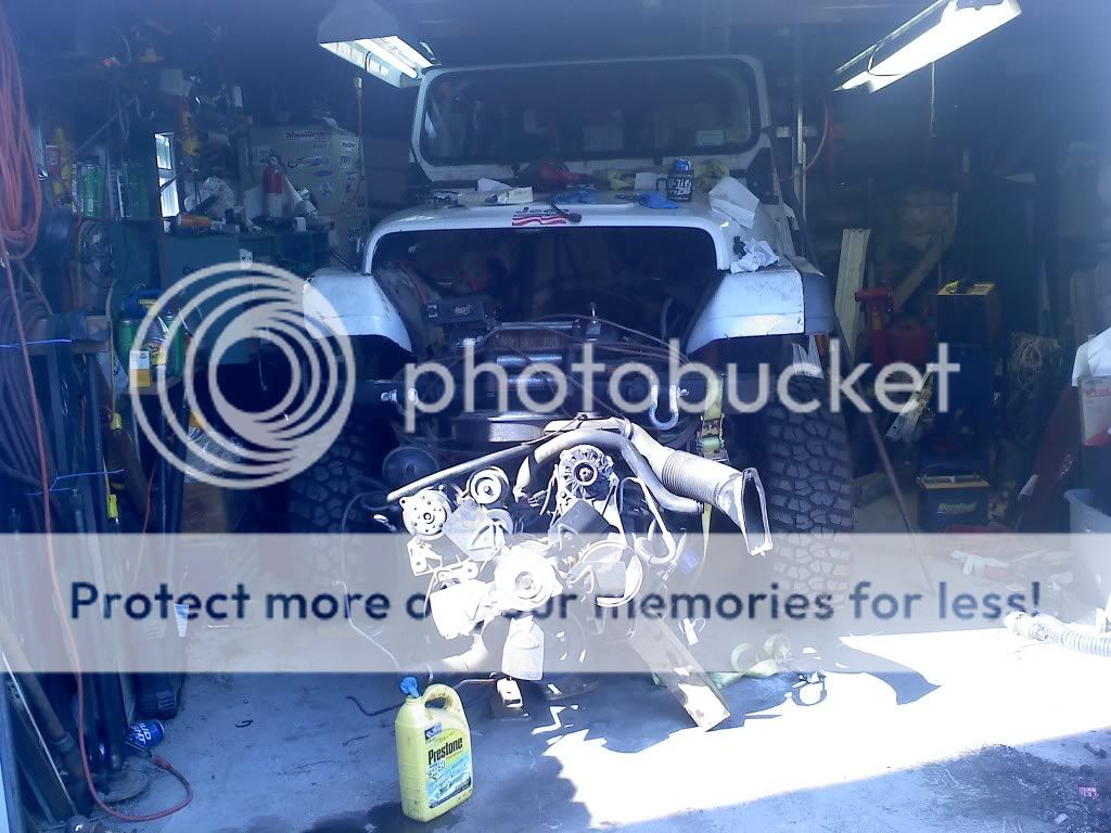

Whats funny about this picture? I had to keep the sun out of my eyes
I also picked up this today
Trying to figure out how am I going to hoist the motor in and also check for hood clearance?
Still aiming for this Saturday to get the motor in

Any other modification needed for the block besides taking off the old setup and screwing on the new nipple? I may have to do this...
