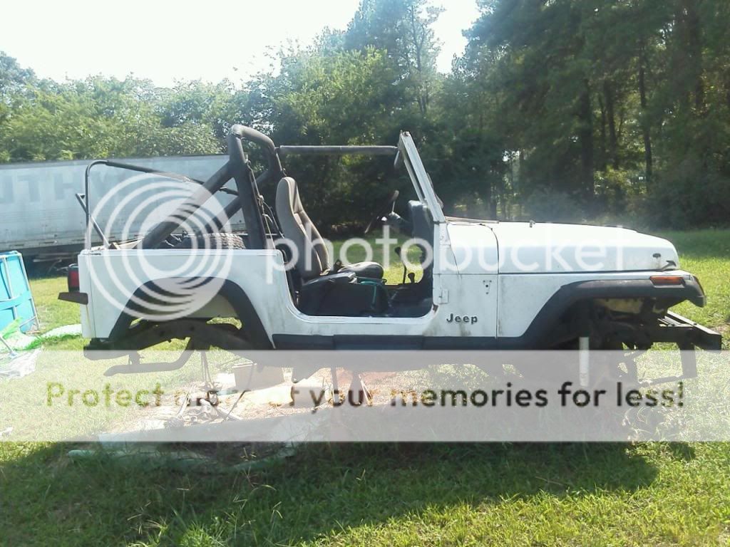

thanks for the info , but i came across an easier cheapier route, i grabbed a 91 wrangler 4.0 fuel injected, 5 speed. for..................$500 and ive got the tub and frame sold for $300 so im only gonna have $200 into the whole swap from carb to fuel injection and from auto to 5 speed
and everything should just bolt up since everything is coming from a wrangler, heres a pic of what i got. everything is there but the rear end.
Sweet deal and a good find! This will definately make things a lot easier. Keep us posted on your progress.
