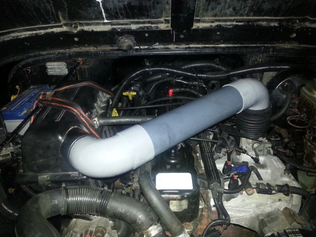

yes i got the date link all hooked up just no Bluetooth adapter so i can read off my phone, i suppose i will have to order one.
couldt it be that im using the spear key and all taped up in the immobilizer
I ordered a new filter but that not heir till next week so i made one out of the what i had left from the xj aif filter box,and some drain pipe for now.
i couldn't wait for the filter

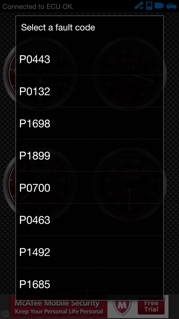

Originally Posted by Que89YJ View Post
It will but not directly. Post the codes.
it says i have no pending fault codes.
and these are logged codes

i wasnt getting any where with the torque lite app so i went looking for an other app called Carista , gave me these fault codes

You need to clear the codes and drive it again. I thought it was o2

post #195 of 252 Old 10-19-2013, 12:43 PM Thread Starter
lbsickboy
1986 YJ Wrangler
Location: Den Haag
Posts: 193
Ok so codes,
P0132 EVAP sensor
P0132 o2 sensor bank 1 down pipe front exhuast ( http://www.doityourself.com/stry/how...xygen-sensor#b
P1698 Transmission speed sensor
P1899 park/neutral switch
P0700 TCM automatic transmission
P0463 Fuel sending unit volts high this is i think because i dont have it conected up to as we all know im waiting on the new gauge(would it bea good idea to connect it up when the gauge comes in?)
P1492 Evap canister purge control/valve circuit
P1685 SKIM invalid key ( i will swap out Keys)
