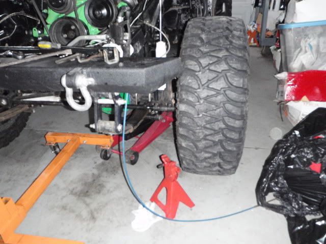

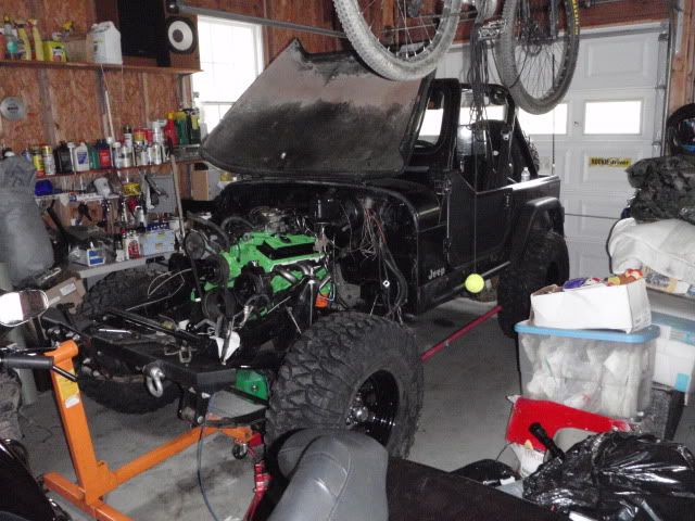

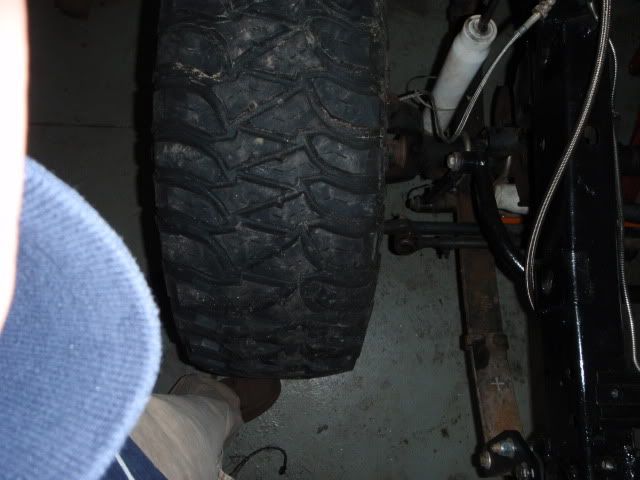

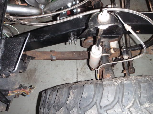

post #6 of 6 Old 04-27-2010, 02:58 PM Thread Starter
Toms87
1987 YJ Wrangler
Location: Maryland
Posts: 1,516
I just measured and it looks like I only have 8" between the sidebiter tread on the MTZs and the leaf spring. Looks like my wheels are turned but I have no front end right now so it's kind of hard to tell. I *think* i did have a little leaf spring rubbing going on with 33x12.5s but didnt do any wheeling with them so I'm not totally sure what was going on there. Here are some pics...
