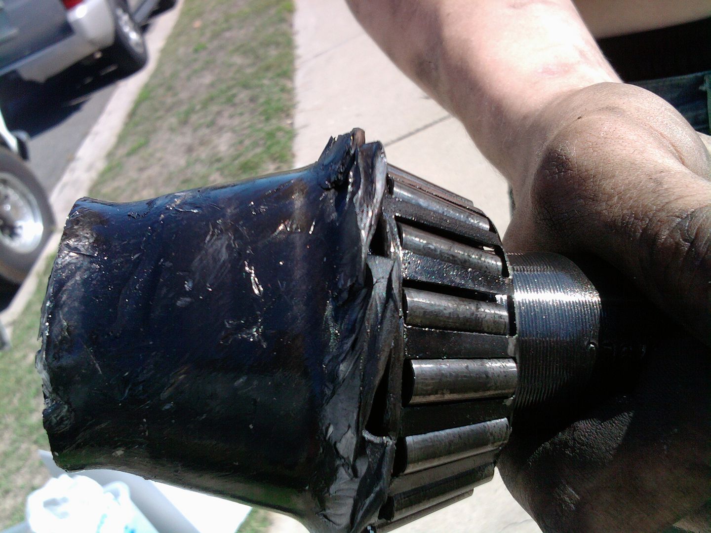

My Dana 35 on 33 inch tires broke going up a very small hill on the trails.
Now I'm in the process of installing an 8.8. When finished I'll have less than $500 in it.

OUCH!!!! I will stick with my 33s!!! Thanks to all of you for the info and pics. I can always count on all of you from this forum for good solid advice. thanks.
