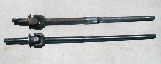

well its a two piece axle shaft on the passenger side so when the vacuum disconnect or the posi-lock is disconnected the passenger side axle is two separate pieces
the on on top is a two piece yj shaft the bottom is a one piece like xj's and tj's
