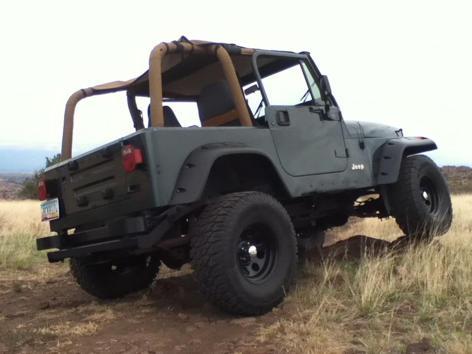

Took the Jeep out today to make sure everything worked good and nothing was wrong, took it on a little trail behind my parents neighborhood. Here is a Pic
Also was the first time i took it off road handled really well, reminded me of what I've been missing since I sold my last YJ.
