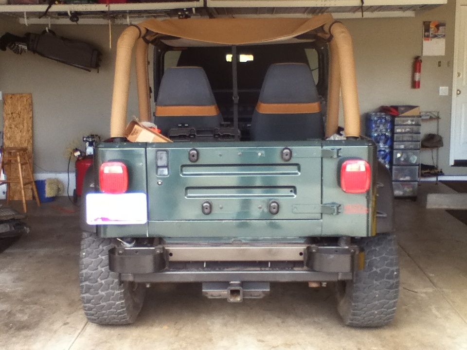

I got all the bolts out without breaking any all i need to do now is get a different radiator lift the one that was on it from the 3" lift lets it hang to low. Here are some pics.
Before
After
Cant wait to take it out need to put the radiator in when i get the new brackets and i also have to replace one body bushing mount. Anyone got any ideas where i can find one stock body mount??

Looks sooooooo much better! Nice work!
How is your rad mounted? Pics please. You should be able to just remove any extra mounts and bolt it up to the stock locations.
Check out quadratec. I'm pretty sure they sell a wide range of new mounts from OEM rubber to poly.
