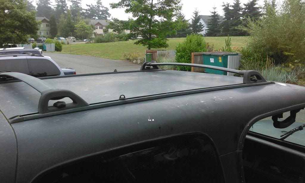

Its wrecked. High miles, tranny going out. All kinds of issues with it. So i took the roof rack off and tossed it onto my hard top. Have to say i really like that.

Also, I wanted to ask how you attached the roof rack to your hard top? Did you just bolt it on? How do you prevent leaks?

@Apollo12227 As far as the roof rack. I drilled holes just big enough for the bolt. Then lubed it with 100% silicone. Went underneath and put 4" by about 4' rips of 3/16 aluminum inline with the frame of the rack. Not before adding more silicone in between the plate and roof. About 10 washers with more silicone and some locking nuts to finish it off. Must have done a good job as it has not leaked once. Once work down at the ship yard picks up for some winter work. I will add to the frame a little inside. Would be nice to have it support a little more weight. Works really well. Ive had my downhill bike on there and the top does fine. I would not suggest putting a lot of up there. But some camping gear will sure fit. Cant even hear it up there. As if that is a surprise......
