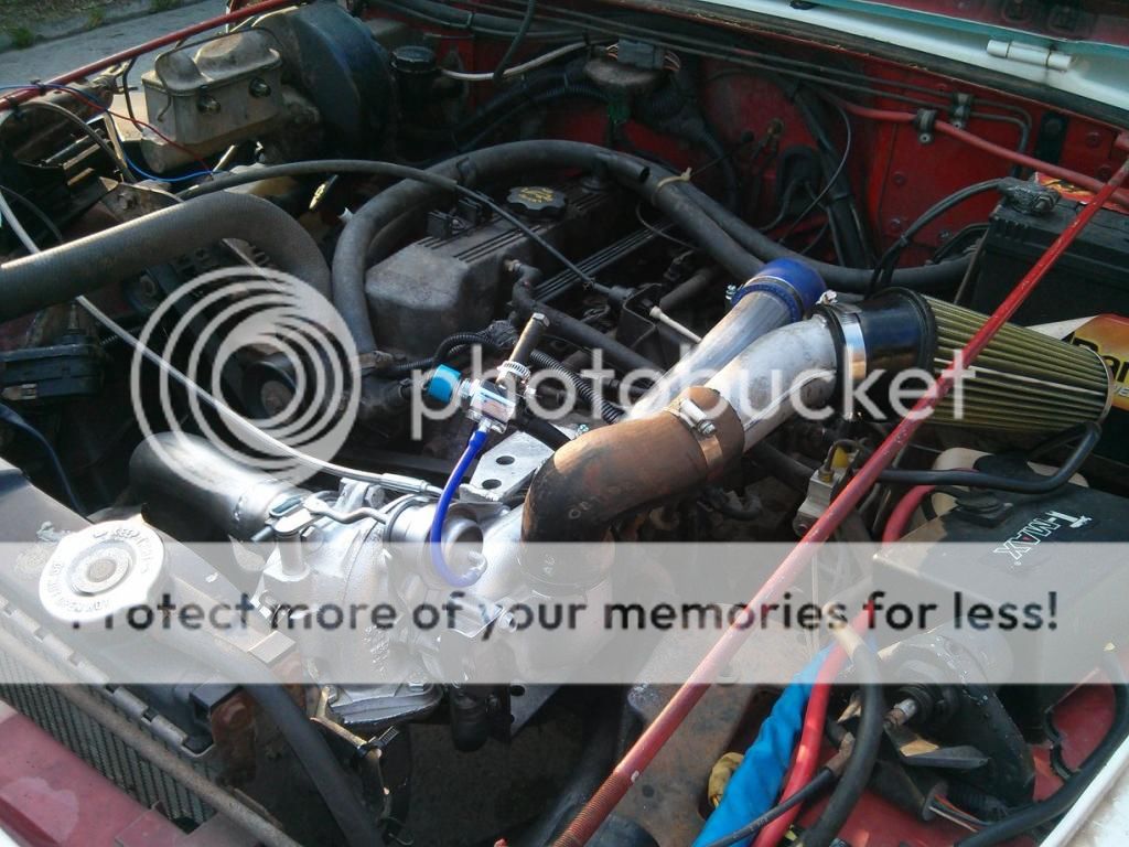

Hello. Is it possible to install a 2 bar map sensor on my YJ just by removing the stock 1 bar map sensor and plug by cutting the wires and install another one. Its for a boosted YJ. Will the ECU be ok with the readings of boost? Thank you.
P.s the map sensor is from a saab aero

I have already seaeched but not a clear answer was found anywhere. Mine is 2.5 l and is already turbocharged, but the map sensor dont let the boost rise and cuts fuel. Only at 20% of throttle it can be driven. Thanks for your help anyways

I made all the above that Que89YJ stated but it cuts fuel as the map sensor reads positive pressure.

I know that the ecu is the problem, but being a budget buildim trying to keep the cost low. This build cost me about 700$
