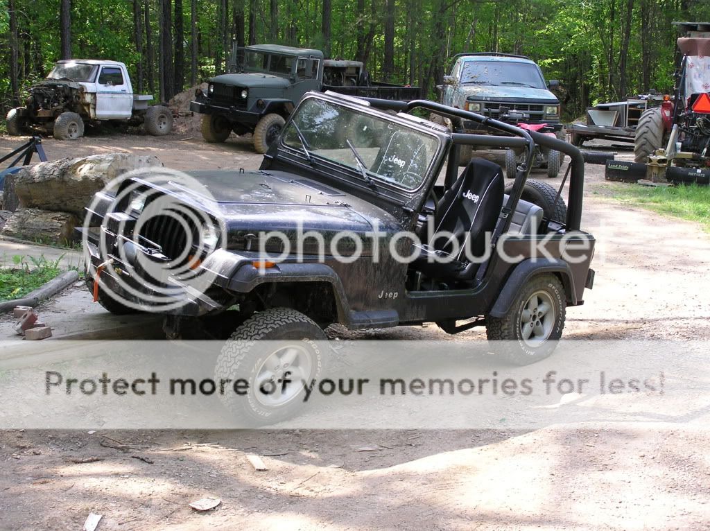

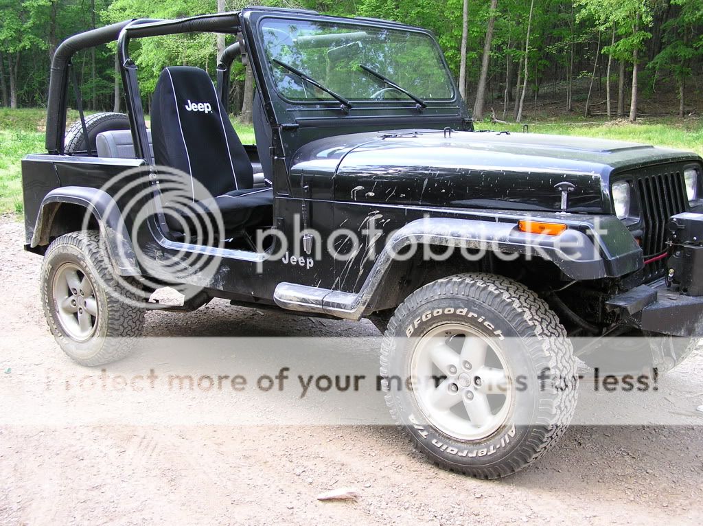

post #8 of 20 Old 04-17-2010, 03:27 PM Thread Starter
Eric78
Location: jemison
Posts: 14
Eric78 is offline
post #9 of 20 Old 04-17-2010, 07:25 PM
Nates93yj
Nates93yj's Avatar
Location: Dubuque
Posts: 1,159
Looks good

Yeah, and it flexes like crazy!
No need for the roll eyes comment, looks like it flexes real well. Considering his rear leaf is inverted and it was dirt cheap or free if your the op

Look at the thickness of those truck springs. That's exactly where they belong: under a truck.
The ride in that thing is going to be terrible.
