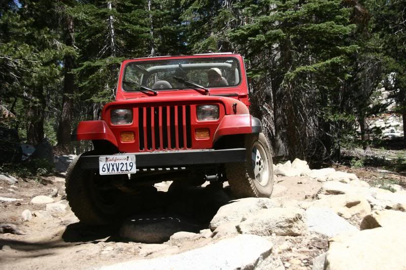

Before I left I decided to take the sway bar off since I wasn't sure if it was going to make it even with it disconnected. I left work early around 2 o'clock and started heading up the 5. 105 degrees outside, no top, no A/C, and I was already working in the heat before leaving. It was hot, sticky and I had to stop every 30 minutes to pee because I was drinking so much water. But my little 2.5 was putting along quite well. I was cruising up the 99 at 75 mph no problem, and even maintained that speed going up the Grapevine. As soon as I got up the Shaver Lake, I knew it was worth fighting the heat the whole way up. The weather was perfect and I couldn't wait to get out on the trail on Saturday.
My dad decided to take his CJ7 and his dog Raz up to so we can both go wheeling together. After going over both of our Jeeps to make sure everything will work smoothly, we headed up. Got to the trail head, air'd down our tires and started on our way. My Jeep was conquering the trail like a champ, didn't get stuck once nor did it lose traction at all. My only problem with it was not having power steering makes wheelin a real workout. Needless to say, thats next on my list.
