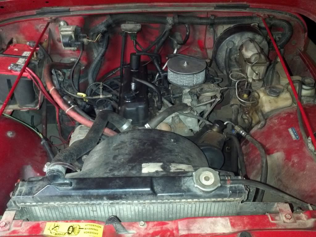

so a few weeks back i went and traded a really nice audi a4 for what i thought was a bad *** jeep. 1990 yj with 2.5l TBI. well i should have done my homework first. the jeep needs a ton of work but it looked so cool i looked right past all of it. the jeep looks to have a 3 inch body lift on a spring over lift with a trans drop on 39.5 inch swappers. this thing was big![IMG][/IMG]
[IMG][/IMG]
the person i picked this up from was not the brightest and had a lame excuse for running such big tires on stock running gear with only a 2.5l. so with smaller tires in mind i picked it up and drove it home. after about 20 min or so of driven my eyes started to burn from running so rich. got the jeep home and decided that the first thing i needed to do was get it running right. i ended up rebuilding the throttle body and replaced the injector. while i was under the hood i noticed that every single vacuum line had ben chopped and plugged. all tune parts looked to be new including the o2. she started right up and ran 100% better but still rich. i decided that i needed to replace all vacuum lines but before i had a chance to do so i got a offer on a set of 33's in trade for my 40's. i jumped on it. drove the jeep home that night, about a 30 min drive and parked it... now she will not start. also the oil looks to have a qt of gas in it. any ideas would be grate.

Drain the fluids and refill them with fresh versions of what should be in there. Then fix that death trap disguised as a steering setup.

Normally Anticanman is pretty easy going about bad spelling. As far as spell correct. If you use Internet Explorer the spell check may not work. Doesn't on my computer with the Jeep Forum. Now all that I use is Google Chrome and spell correct works fine in this forum.
That said, he is very right. Replace all fluids before you drive any more miles. From there you can monitor what you have and how good or bad things are. Fresh fluids will give you a start point to monitor the looks of everything. Motor, tranny (Use 10-30 motor oil in the tranny), transfer case, and front and rear end. Might help the tranny grinding too.
I also agree with Anticanman about the steering. I hate to tell you but I think you should park your rig until you make it safe.

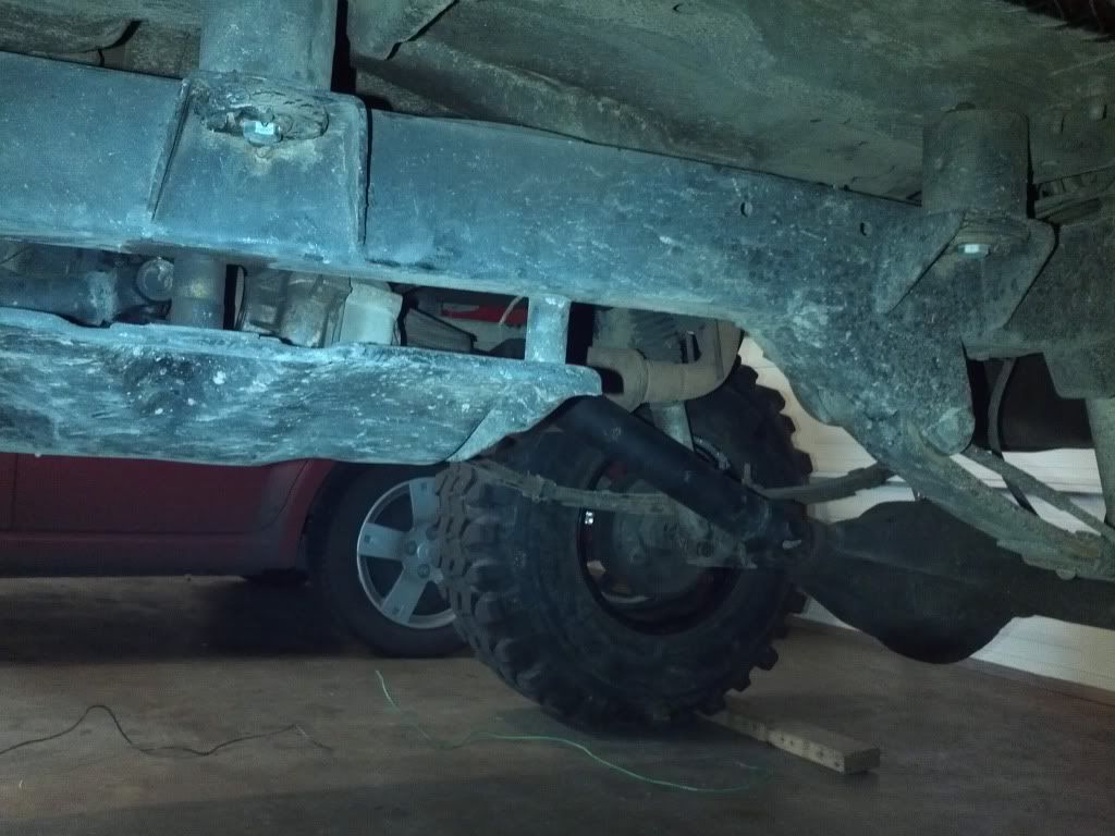

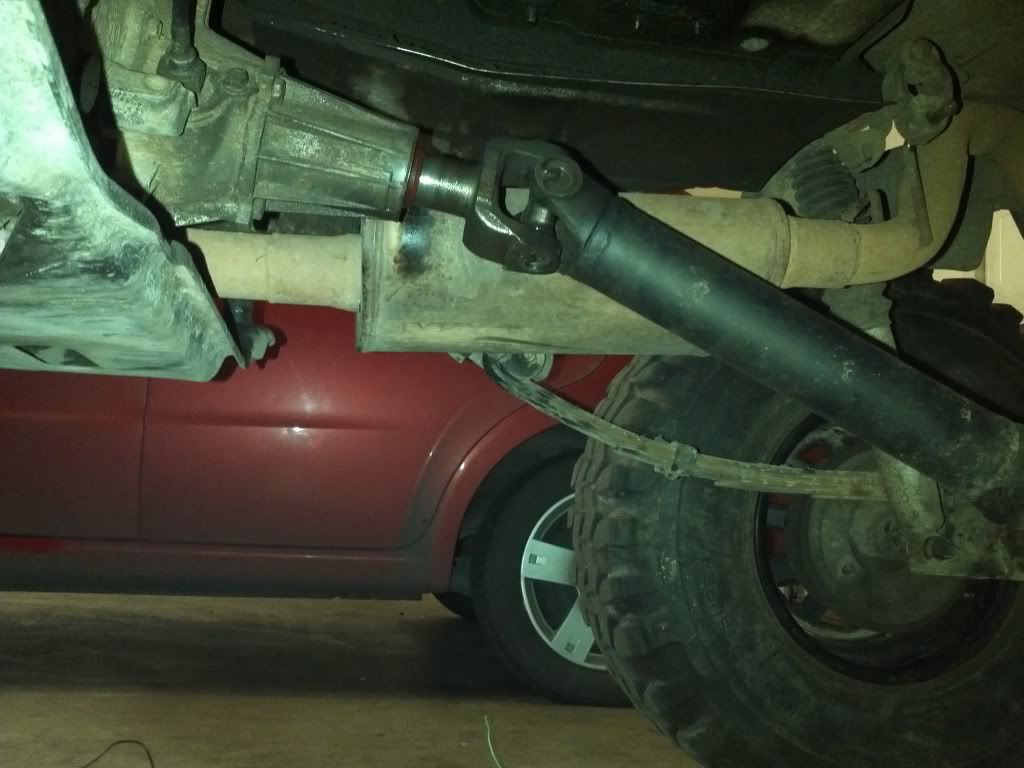

It's not that you're a bad speller, its the bitter irony in the situation. That being said, lets move on to getting you diagnosed and back on track with the project jeep you bought. Can we get a picture of the rear output of the transfer case so you can have a little better idea of what its going to take to remedy this clusterjunk?

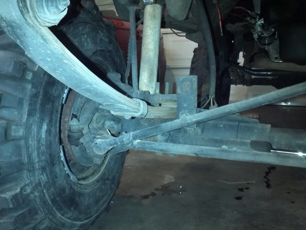

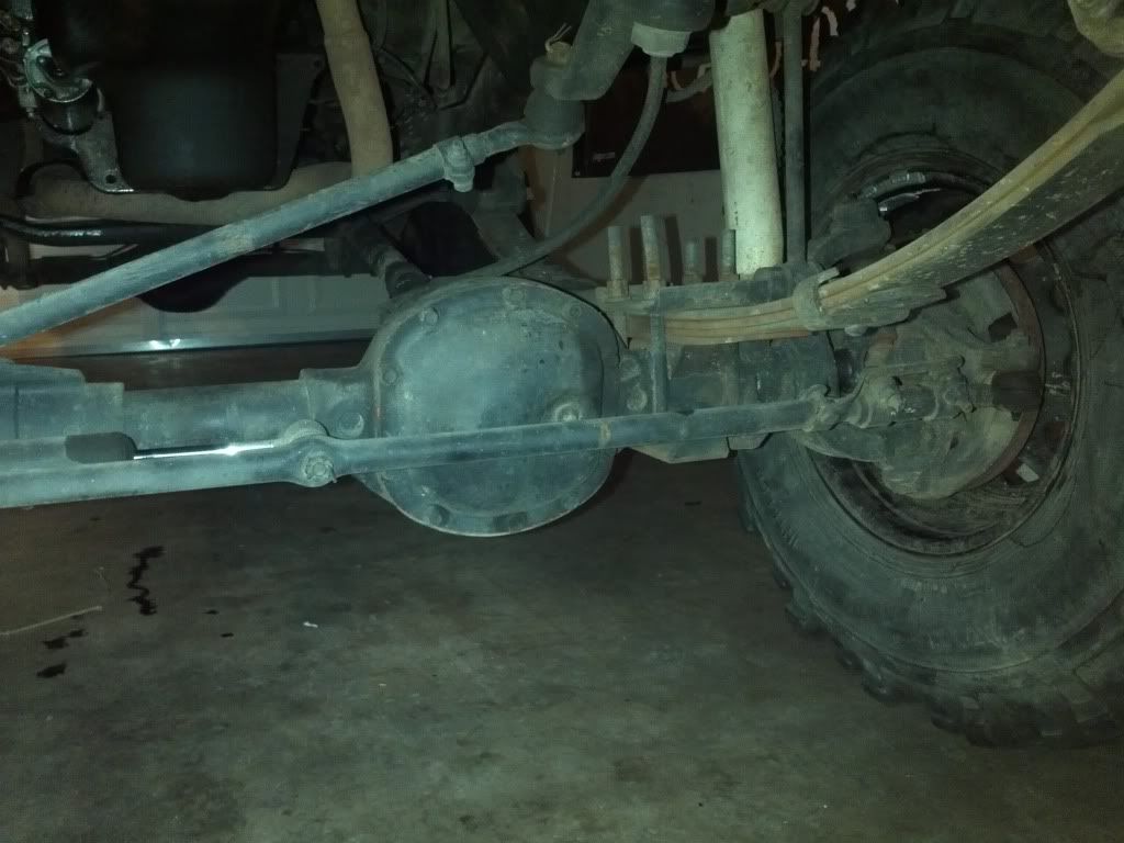

[IMG][/IMG]
[IMG][/IMG]
[/IMG]
[IMG][/IMG]
[IMG][/IMG]

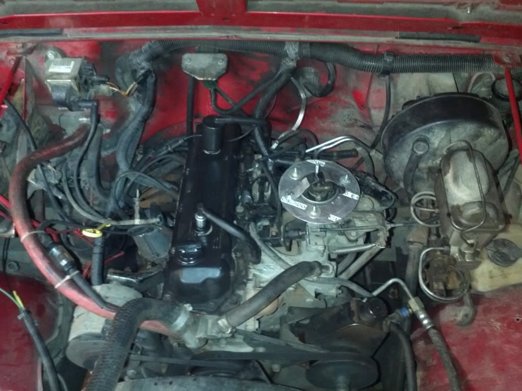

and a photo off all the cut vacuum lines including the lines for the front diff.
[IMG][/IMG]
[IMG][/IMG]

The steering will have to be addressed to drive it on the road and the slip yoke on the transfer case will have to be adios'd to drive it on the trail. Scratch that. Off the trail.

Your on the right track sizing down on the tires . Its a step backwards but you may want to consider going back to sprung under . That would be a quick fix for your steering & drive shaft geometry . In my limited experience I've never seen at case tilted that much . There must be a motor mount lift along with the T case drop .
Looks like the PO was trying to make a quick sale .
