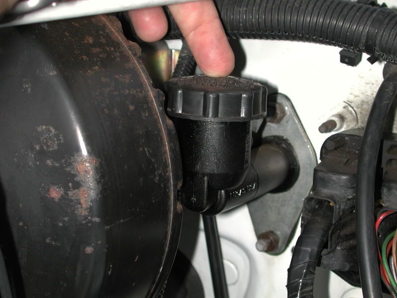

So where is the reservoir located? Is there a source where I can see a picture of where I need to look? When I had the oil changed they didn't mention I was low on any fluids or anything.
Here it is.
I would not be the least bit surprised there was no mention of other fluids, very doubtful someone would check this on an oil change unless you were to specifically ask for them to look. If your pedal still feels normal, it's not likely to be clutch hydraulics, but if it is limp and mushy, it's a possibility. Have you checked the lube in your transmission? Is it low, empty, has shrapnel in it etc?
