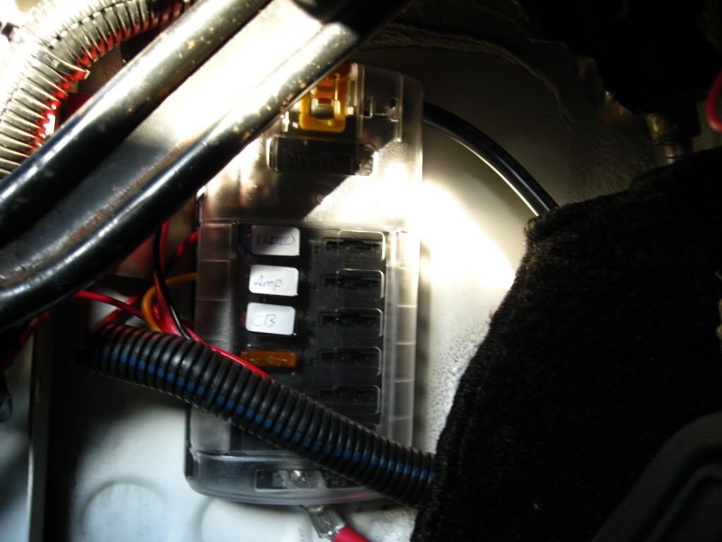

If you simply cant find a fix I recommend going with a new box. The manufacturer of this is Blue Sea Systems, but you can get something similar. Im an associate at West Marine so I dont quite remember retail cost, but its made life 100x easier.
