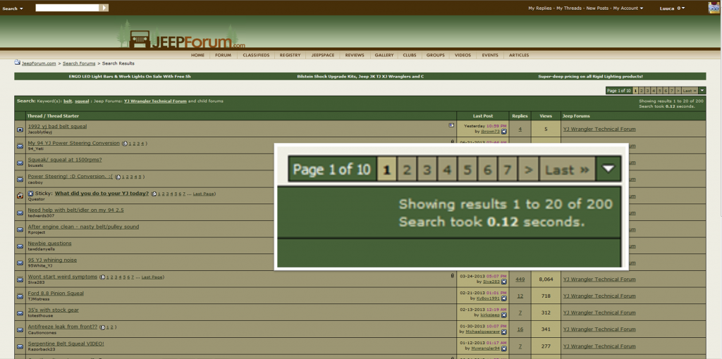

Over 200 threads with the keywords "belt squeal" in them. Took .12 seconds to find and load.
If you teach a man to search....
