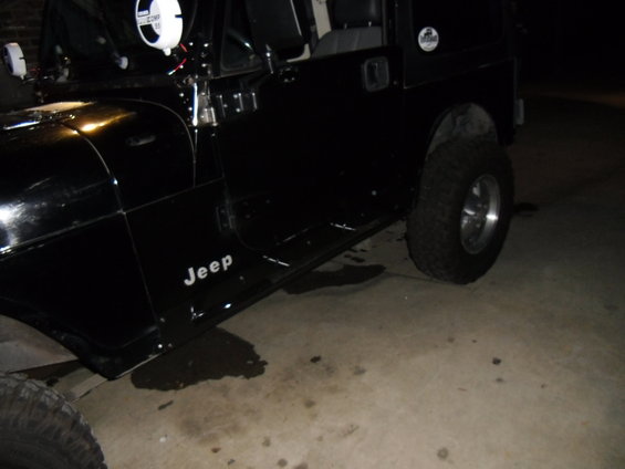

and built a set of sliders for it...(pics are kinda dark)

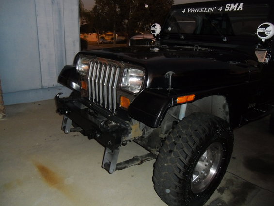

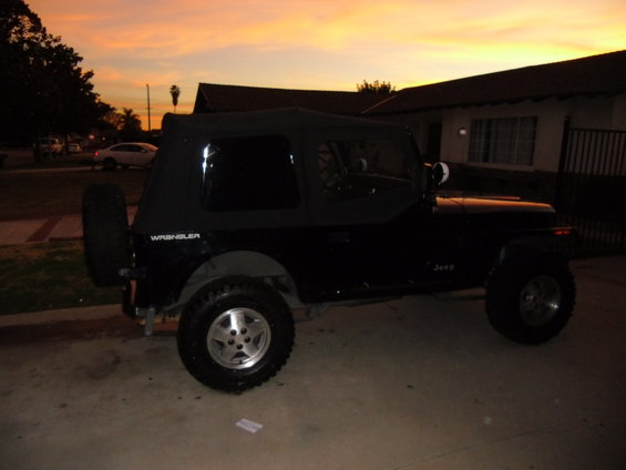

few more things...
installed the new to me softtop (besttop) and half doors (painted to match)
trimmed up a stock from bumper
also installed a procomp rear bumper and wired up the pillar lights.

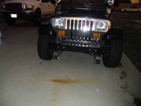

last weekend's project, tubed fenders with built in flare.
1.5 inch diameter .120 wall, same material I made the sliders out of, should take a hit pretty good.
I have 1inch led's to install in the tube for side markers but I need to grab a 3/4 hole saw to install them.

I was just wondering how you attached the rock sliders are they just bolted through the body or do they have more supports going to the frame i would appreciate if you could snap an underneath pic thanks
right now they are just bolted to the body, I plan on running a couple of legs per side to the frame with a bushing to help the ride.
